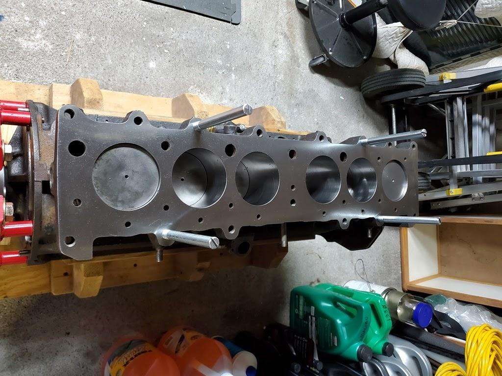

Thanks Bloo you helped me get my steps in today walking back to the shop, that sure looked like a crack but it must have been some gasket trace.
Here is an updated photo of the spot.
Looks like a wire in the coolant jacket, is that common?

Left over from sand casting the block I'll bet.

In another vein, George Childs (another VCCA guy) found LOTS of wires in the water jacket of his 1933 engine when it was rebuilt. He also speculated that these wires were left over from the original casting process.
