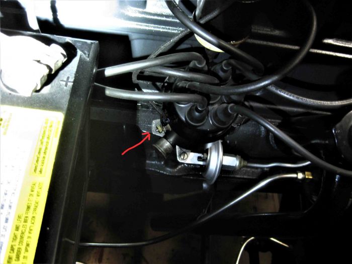

I've spent the last few days adding some things to finish up the restoration. New manifold gaskets, new light bulbs, added turn signals etc. But I'm constantly amazed at how much work someone already put into this machine! I'm going to try to attach some photos here to show this fine automobile.
EDIT: It appears I cannot attach pictures directly, so here are links instead.
[img]https://ibb.co/1qRZLgb[/img]
[img]https://ibb.co/rQyDj4D[/img]
Just wanted to show a quick shot of the underside too. Outside of the tail pipe needing to be replaced, this car has no rust perforations at all. Even my 2014 Chevy doesn't look this good!
[img]https://ibb.co/hZT766Z[/img]
QUESTIONS
I am no expert when it comes to this car specifically, though I have reasonable knowledge of cars in general since my father has 50+ years in automotive restoration/repair. Still, I have a couple questions for you knowledgable folks.
First, here is a double-shot of something odd. I have the high-beam foot button in the normal position, but way above the steering column there is another one. I have circled it in red. On the other side of the firewall there is live power coming in from the left and going out on the right. Whatever was on the right was disconnected, but I checked and when the switch is pressed there is power there. Anyone know what would have been there? It definitely looks factory. Keep in mind this was a Canadian-built car. I should also note that the position of this switch is so high I almost cannot reach it with my foot!
Unless someone knows what should be there, should I remove it or should I just attach an ahwooga horn since there's already power there? laugh The switch on the floor, if I recall, releases as soon as my foot lifts off it, so I think that rules out it being an old driving/fog lights button? If anyone thinks that's what it is, I can confirm the button is not an on/off "kick" type like the normal one for the high/low beams.

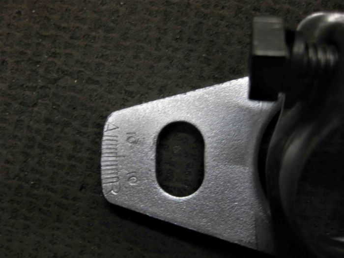

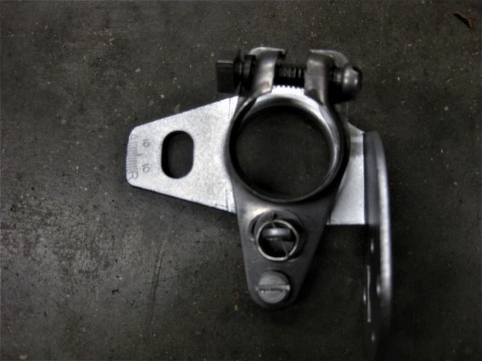

Another question: I have read about Octane selectors in these vehicles, but never actually seen one. I checked the American version of the service manual and it seemed to indicate that I would find it as a silver button below the distributor, and though I thought I spotted it, it turned out to just be the grease cap (which I refilled with grease since I had it off). Anyone know where I can find the octane selector? Is it just not present on Canadian build Chevys of this era? I talked to two Chevrolet enthusiasts, both Canadian, and they say they've never seen one either.
[img]https://ibb.co/C2zT8J9[/img]

Your car does not have an Octane selector. Can't tell from the picture if the reversing switch is mounted and working.

The octane selectoe is adjusted by loosening the bolt in your picture to the left of the grease cup. The bolt threads into the block. Clean-up that area and you will see A and R marking stamped in etc.
Difficult to believe no one knew about the octane selector. Chevrolet used that adjustment arangement from 1939-1962.
If it were my car I would remove the gaggle of wire and switches to prevent future shorts and problems.

OK I can see them all now. I am not sure about that switch but some folks like to hide a kill switch of some type to make the car hard to steal. Wow you have a pretty nice old Chevy there!

Thanks kindly for your response. When you say the octane selector is the bolt to the left, do you mean the hex bolt immediately to the left? If so, yes, that's quite the hiding spot, but if it's still set to "0" my understanding is that is when octane was a bit closer to 70, and so I should advance it to 8 or so. Will there also be numbers that I can use on there?
Yes, for the wires, I'm going to clean them up, put on electrical tape, and move them a bit higher. I have big feet so I want to be sure I don't kick them.
First if you clean up that area at the base of the distributor it will help. When the bolt is loosened the base retaining the distributor will rotate. Also if the vacuum advance is working the entire distributor will rotate under load. Start engine and speed up engine (at the carburetor) and you should see the distributor turn or rotating several derees.
The octane selector was used so the owner could advanvance or retard the timing by used the + or - on the octane selectoor.
The corect way was to set the octane selector at the center 0 mark. The set the timing with a timing light as the factory setting. Then drive the car and advance the timing with the octane selector so the engine pings slight at low speeds and full throttle. With todays much higher octane gas you will not make it ping at any setting. Usually they run bet setting the octane selector at 8 degrees advanved. More than that usuall results in kicking back when starting.
If you wish yo can play around and advance the timing with out going thru step one and find the sweet spott

As Chev Nut said, if you would clean up the area around the base of the distributer we would likely find an octane selector.

The octane seletor operation is in the 1941 Chevrolet shop manual - in the engine section under engine timing.
Also in the owners manual

Page 173 under "road test" gives a brief amount of info. concerning the octane selector----in the shop manual.

In regards to the discussion of the octane selector here are some pictures that should help, and by the way the pictures you have posted are awesome. Some of us visual learners really, really appreciate them.
Good Luck, Mike
