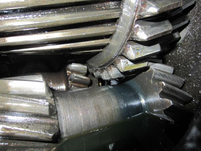

Today I worked a bit on my Chevy and opened the transmission, to see why it always scratches when changing gears.
Can you even look at the pictures and tell me if the gears are in good condition? I think the 1st gear flanks are very rounded? I also found some metal shavings, I think copper? Can that be from the Synchronizer Rings? Thanks for help.

No, not yet. I must do this too, but my brother in law - the previous owner - means that some gears were worn-out. Now i would check this with a look inside. Upshift scratches almost allways, downshift is better. I´ve tested with a longer break between shifting, with gas between, fast, slow - nothing?!

Are you using a high viscosity lube? SAE 160 or 600W are thick like molasses or cool honey. The high viscosity lube helps to synchronize the gear speeds.
It was common for cars with the vacuum shift to wear out the syncronizers. This was because the vacuum assist would change the gears with more force than a manual linkage would. The most common problem would be grinding of the gears when shifting from 2nd to 3rd gear. Years ago we just replaced the complete syncronizer drum. They are almost impossible to find today and very expensive.
Gear wear. If the edges or tips of the gear are worn or chipped a little it will not cause a problem. The wear that can cause excessive gear noise is when the tooth contact area is worn or rough. Also if the bushings in the cluster gear are worn....brass bushings.

@ chipper - My Brother in Law filled in SAE 90?!
@ chevynut - thanks for this information. I think for a better diagnosis i must disassemble the Transmission.
With Synchroniser drum you mean Syncro and Sliding Clutch ? On this side they have also Transmission Synchronizer Rings
Is it possible to restore the drum? Hmm,brass bushings? I think there are copper shavings?!

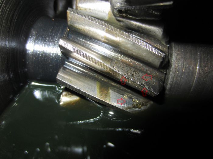

Today i took a second look. what i see makes me not happy.
I think the countershaft gear and the 1st gear / reverse gear shows strong traces of pitting. These metal shavings on the first picture look a lot like brass!
So Chev Nut is quit well and the bushings in the cluster gear are worn. The shavings it has crushed between the gears.
Can you tell me what parts i must get for repair? As example on this side www.vapinc.comi need:
WT242-8 / WT242-12 / WT242-50B Small Parts Kits, what would be even advisable? WT242-18 Synchronizer Rings?

I can't see all the gears that well but as far as the gears go it looks like you will need a cluster gear and shaft, First and reverse gear and 2nd speed gear. If the gear on the front shaft is bad you will also then need a main drive gear. And of course a syncronizing drum.
These parts fit from 1940-1952 for the most part .

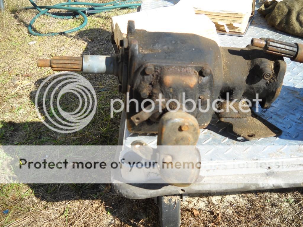

Used 1940 complete transmission. See photo. I have not opened it up for inspection but will do so if desired. Weight 48 pounds as is.
I can remove externals if desired to lessen weight. Your call. I don't want to tear it apart though, i.e., take the gears out of the case.
If you can use it, it's free (to you.) No charge. You merely pay the shipping only which you will have to arrange.
Best wishes,
Note to monitor: Please excuse the "blah, blah." I'm merely trying to help a fellow member. I hope that's okay.
[img:center]http://[/img] [img:center]http://[Linked Image from i753.photobucket.com][/img]
