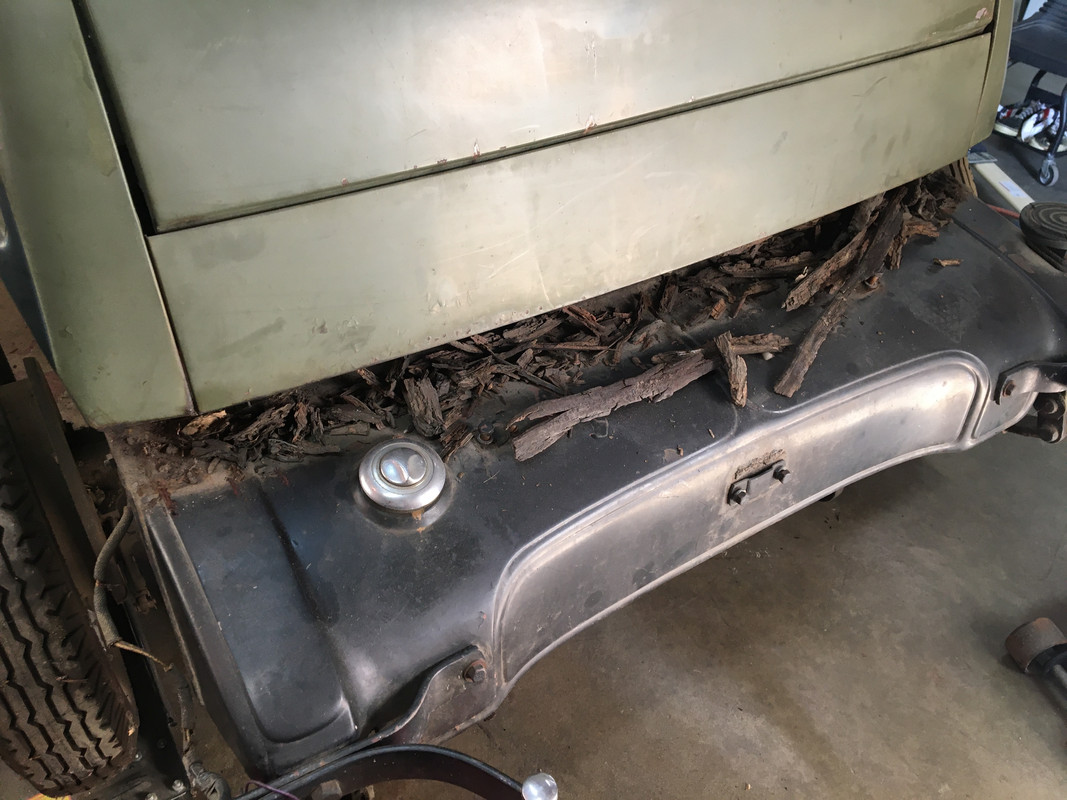

If this was directed at me I’ll just drop this in here to remind you of your hard earned knowledge: FYI, I contacted everyone making wood kits by calling and leaving messages as well as multiple emails as well(over 10 times on each contact attempt) for over 5 months. Not once did I receive any call backs, messages, or return emails. It’s not like I hadn’t made every attempt to purchase the WOOD itself from a reputable vendor but if they can’t be bothered to try to respond, WTH should I do? I understand why your protective of your craft, but if you condescend to younger people who are actively TRYING to keep the restorations around and not just turn them into hotrod or some other atrocity maybe people should encourage them instead of assuming you know their situation and going on a rant that’s uncalled for. Oh, it’s also not like I wouldn’t have made my own pattern but I’ll drop this picture here to show the state of my cars ‘wood’: Maybe you in your great hard earned knowledge could salvage enough to make a pattern from that? Rant over. I’ll just make it with steel so thanks @Christech for the reply that was a question for someone else.

Looking at the picture you just posted and it seems you have a 31. The 1929 sills are very much different so I wouldn’t be able to help. All I had from my 29 sedan was about 2 feet at the back of one side and at least all the cross sills. It took considerable time but I was able to map out the main sills for it (picture in first post) so it can be done. Unfortunately I have not worked on a 31 Chev yet so have limited info.

While you’re asking for a main sill, your picture shows the rear cross sill rotted on a 31 rumble seat car. That’s a common piece I make all the time. It’s not a part of your main sills as it’s connected with a steel bracket to the kickups and the kickups are connected to the back end of the main sills. Another piece I make a lot of. There’s a very good chance the bottoms of your deck rails are rotted also judging by the picture. Making one piece from a tracing is not going to fix your issue. Again, I just shared with you a lot of knowledge again so you at least ask about the correct things.
