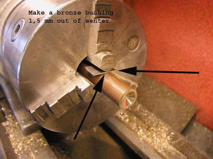

There was a post back in early 2006 that showed how to machine an off-set bushing for the steering box to remove the play in the steering wheel. Maybe someone can locate the exact thread. I saved the pictures but not the name of the post.

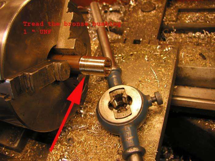

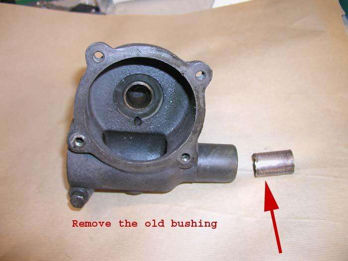

It's also possible to make a one millimeter of center bronze bushing on the pitman arm shaft. You have to cut of a little on the end of the steering gear housing, and take out the inside diameter of the housing to fit a new bushing. Adjust the bushing and secure with some set screw.

I saved them for 15 years. I don't have the text but the pictures have some instructions on them. I hope this helps.
snekke28copy2ia.jpg snekke28001copy9bx.jpg snekke28003copy8pr.jpg snekke28005copy6mr.jpg snekke28006copy5rg.jpg snekke28007copy6bp.jpg
