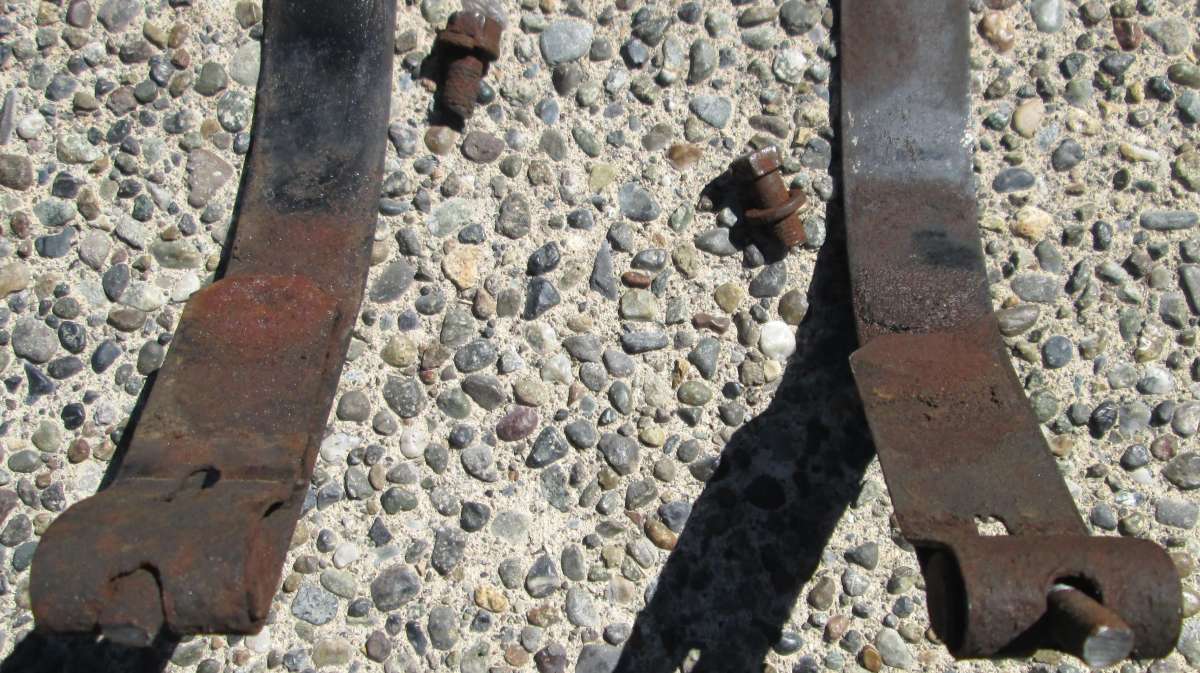

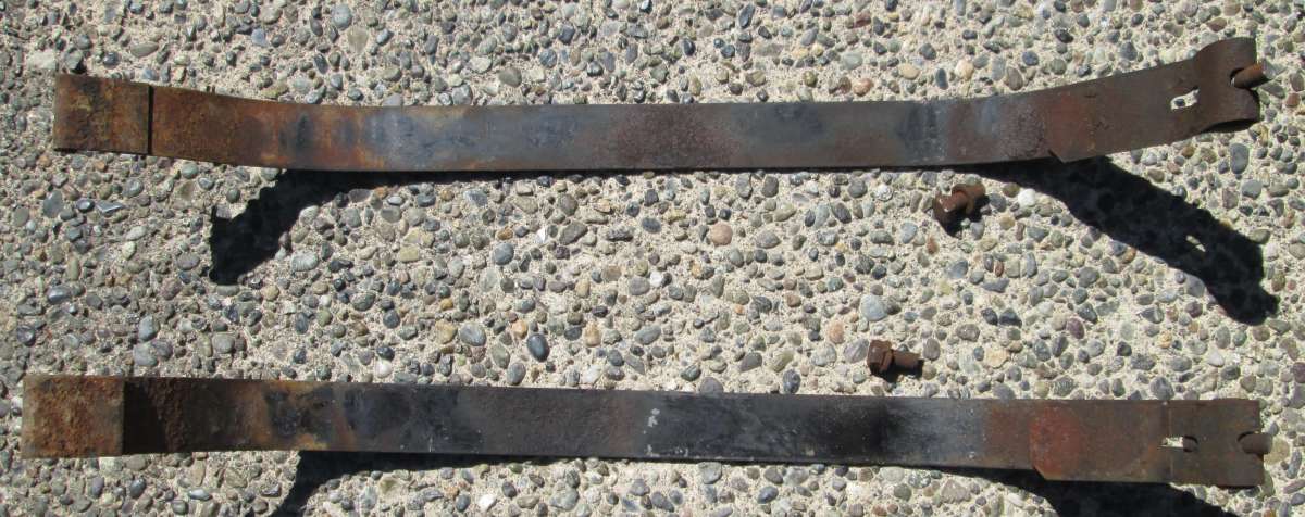

Your tank is not difficult to remove, just awkward. It is outside the car in the rear. That is a lot easier than climbing into the trunk of a coupe and removing the floor.
The nuts that tension the straps can be difficult to remove. Soak them in penetrating oil for a couple of days. Try to hold the threaded rod portion of the strap so you do not twist the straps.

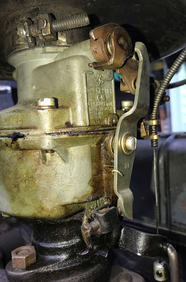

That is interesting that the engine has a Rochester B carburetor. I am not familiar with how that carburetor works on the older 216. Your car came with a Carter W1. The Carter YF was often used as a replacement.

Thanks for that. It couldn't be easier once you learn how. I attached five files and hoping they appear . . .
I included a picture of the gas filler tube as I am also looking for the correct gas filler gasket for my car. There seems to be several variables and people selling them but which is correct as my car came with a piece of rubber with a hole cut in it.

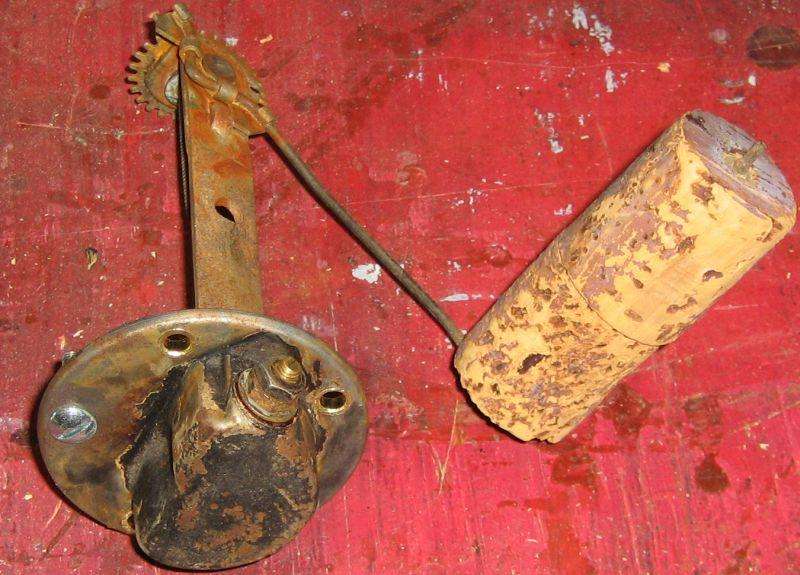

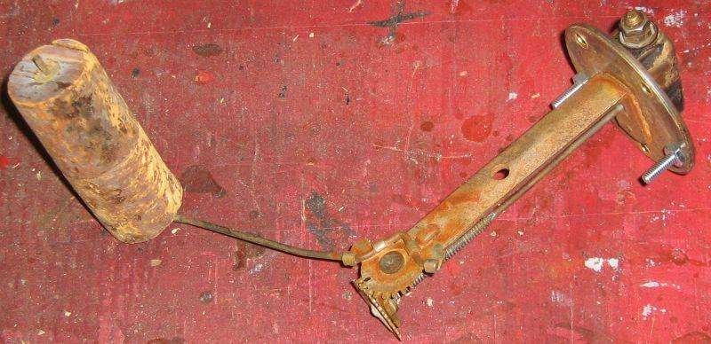

When I stripped my tank out I refurbished the sender unit and cleaned up the contacts on the resistor etc, made a new cork gasket and cut a hole in the trunk floor to enable access to the sender unit once all installed again. Doing that has saved me a lot of time without tank removal again to get to the sender.

Hi Rusty
I think it's likely tig's tank and drain are original to the car.
I say this based on the pictures just generously posted above by Pitcrew.
Although a little hard to see with enough detail, it appears to my eye that their two tanks and drains look the same.
I could be wrong of course.
What do you think?

I was also comparing the fuel tank photo provided by Pitcrew side by side on the screen with my fuel tank and I would agree they appear to match including the drain plug.
I would certainly prefer to keep my original sender if I can somehow resolve the problem when I have it out. I did contact TriStarr to discover there is currently a 5-1/2 month turnaround time to get mine rebuilt. I would certainly not want to take my drive it weekly vehicle off the road for that length of time. My thought is to buy a repop to put in once the tank is reconditioned and get the original rebuilt. Seeing the photos of what the original senders look like are very interesting and comparing them to a repop it is easy to see the difference in quality. The problem is if removing and replacing the tank is as difficult as I've imagined it to be in my head, I won't want to hurry and do it again. I know, I'm not brave enough to cut a hole in the trunk floor for easy access. After a sufficient period of time (5-1/2 months), I just may be up to doing it again.

Useful advice from Rusty 37 on the actual removing of the tank and I will be reading it carefully when the time of removal approaches which will be soon as once I acquire some sort of pump to remove the remaining fuel.
Quoting Rusty 37 regarding the carburetor "That is interesting that the engine has a Rochester B carburetor. I am not familiar with how that carburetor works on the older 216. Your car came with a Carter W1. The Carter YF was often used as a replacement."
When I purchased my car over a year ago now, it came with a Blair Collector Car Appraisal that mentioned the carburetor: " . . . has been refitted with a later Rochester carburetor replacing the original Carter W-1 (Chevrolet issued a Service Bulletin in the 50's recommending this change for all six-cylinder Chevrolet's with down-draft carburetors.) Vehicle also has a later type in-line fuel filter and pump replacing the glass bowl ones "
After updating the gas tank, my intention was to return the car to an original Carter W-1 carburetor, a glass bowl inline filter and glass bowl fuel pump which your inputs would be most welcome. Maybe I need to start a separate thread when I get to that point but for now any thoughts for or against to achieving the end goal would be welcome.
I've attached photos of the Rochester on the car and the untried Carter W-1s I've acquired. I'll need to make a decision soon as whether to the get the Rochester rebuild or one of the Carter W-1s.

Hi tig
I think you are completely on the right track.
Chevrolet switched to the Rochester on the 216's in 1950 I believe.
But some of us think the Carter W1 was actually a better carburetor.
The only issue I've found with the W1 was that I couldn't get any of several I have (including a rebuilt one) to run right at idle/off idle/light acceleration until I pulled 2 of the copper plugs out of the idle circuit passages so I could clean the vertical passage to the needle and the horizontal passage AND the smaller economizer orifice inside.
You will need the right specifications to know which gauge size drill bit to use for the economizer. I have these if you need them.
And use only your fingers to run the drill bits in and out.
And be very careful cleaning the economizer so you don't oversize it.
I had to do the job myself, as most rebuilders don't seem to ever remove those plugs.
So I am now very happy with the Carter W1.
It's simple, reliable, and does the job well.
And like you, I used it to replace a Rochester B.

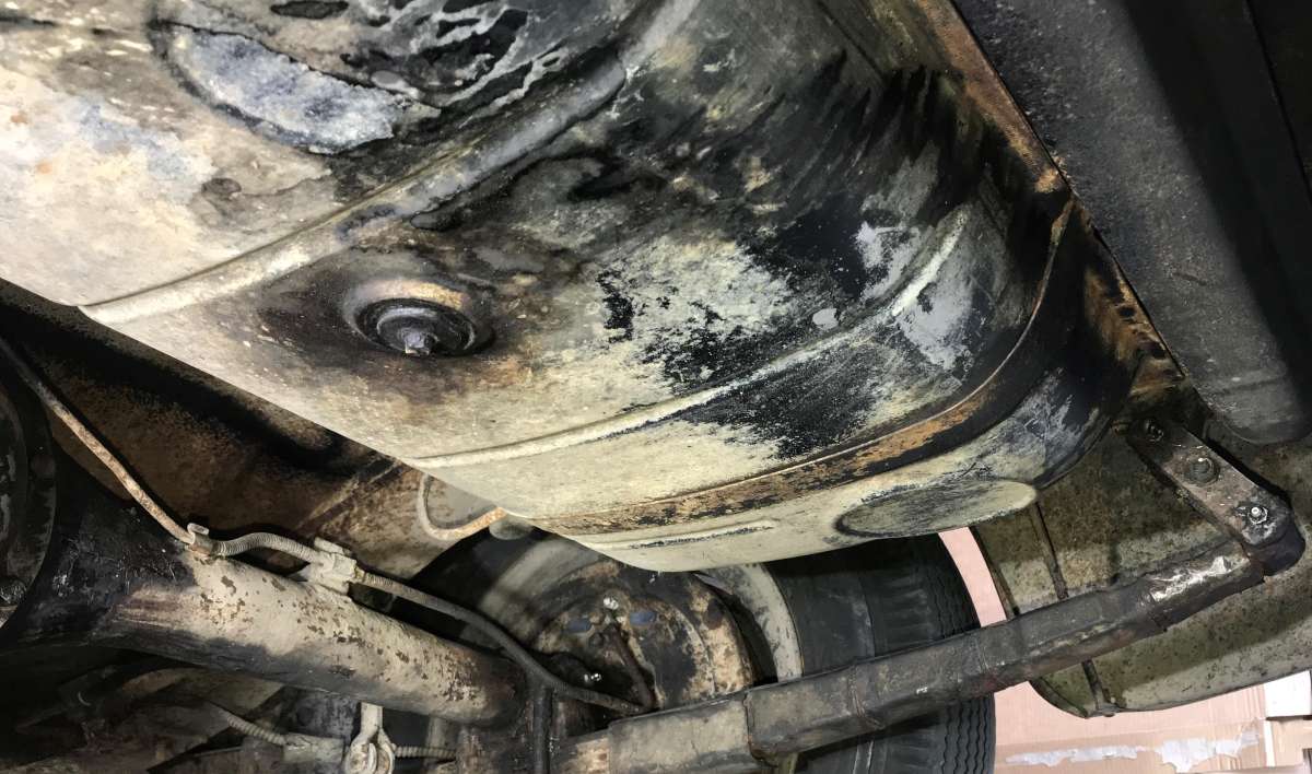

I'm looking for advice on the remaining step or steps on how best to remove my fuel tank. I tried to PBlast the bolts enough to unbolt them and I was having some success on one strap at first and none on the other. In the end, I was forced to cut them with a hacksaw. The fuel line is disconnected, outer straps removed and the fuel filler tube is disconnected.
I had pumped what I thought was the remaining fuel in the tank before heading down this road but after seeing the pressure of the strap being released when I cut the first one made me remove the drain plug. I was sure it was empty so was only expecting a dribble. Luckily, I had some basins handy because at least 3 more gallons came out.
The reason I thought I'd ask first is I'm starting to think I may need to remove part of the exhaust for the tank to clear. I hope not but if so, how much and how\where to? Hopefully just some Houdini trick is all that remains if you can tell me the secret. I assume the rubber on the filler tube to tank needs to be replaced. Where would that be found?
