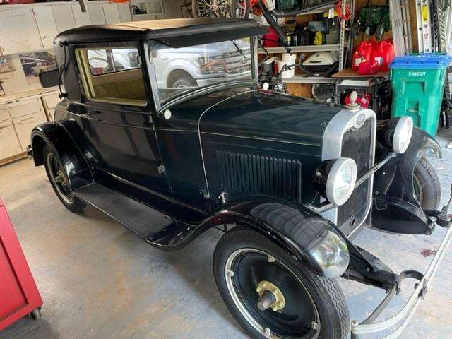

Hi, I am the new owner of a 28 AB National Coupe. I have been reading a bunch on the site so that has got me a long way so far so thanks for all of that.
Prior to even attempting to start this, I pulled the carb and it’s out for rebuilding. I will put fresh fuel in the tank and run it out the line to clear anything in the lines. I have on order, new felt and value cover gasket, figured I would clean that up top and obviously change the oil and aftermarket fram oil filter set up on the passenger side.
Also, planned to drain the radiator and run some fresh water in that and the motor to flush if possible.
Big question, I can’t find a “master” on or off , appears like everything is on, always. Any idea how someone might stop this motor, assuming I can start it, outside cutting the aftermarket fuel pump off?
Appears the key does nothing but unlock the column, which I don’t have but luckily, it’s unlocked.
Any other suggestions is appreciated?
Thanks Steve

Under the dash behind the key steering lock is a lever. This is the on off switch for the ignition. The steering lock locks this as well.

I guess that's what the missing part is here and why I could not find it. Thank you

You are correct. Should be a lever for switch and electrical switch bolted on with 2 screws. I know in Australia the electrical switch is hard to get.
