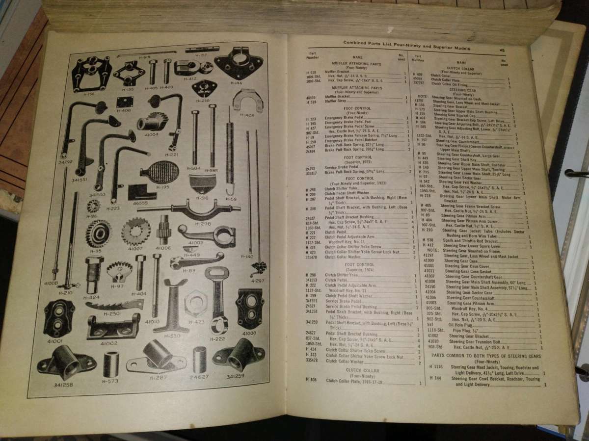

These may help. Not sure on yours but I have heard of some speedos being driven by a gear on the front wheel.

They turned out a little out of focus. I can try again if needed

What book is that from Dave? I have the regular 490 and 27-28 repair manuls, but everything else I have is 30s and up.

Rooster here are some pages from the parts manual. If you enlarge the picture they are very clear. The Ebrake on a '23 is different than a '24.
Stephen

rooster,
Same book as Stephen put up.

Ill look it all over. I wound up with several e-brake handles! The pictures and diagrams help alot! And now I another book to look for! Thanks guys! Im learning alot!
