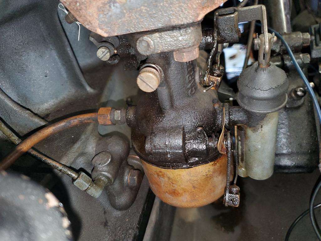

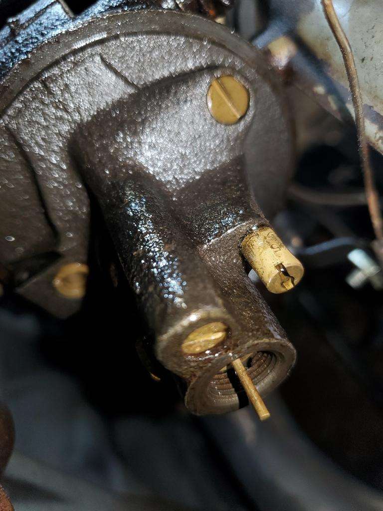

only thing odd was that when trying to start there was fuel coming out of carb, dripping not running. i dropped the float bowl and checked the float and needle. both moved freely and set around 3/4" and the needle moved freely, dropped right out and went right back in. but still dumping fuel in the carb. we let it sit for a few, then tried to start with starting fluid, but still a no go. it spins strong but does not try to start, not even a hiccup or a burp. just spins.
i wonder if it is NOT getting fuel to the cylinders or flooding it out. but seems like it would fire up then drown out if flooding. I am a little lost at this point. what to do what to try next.

The fuel coming out of the carburetor is of concern to me. The engine will not burn a very rich mixture. Adding starting fluid may hurt not help. If the internal bowl vent gets plugged the float will not shut off the fuel flow. It is necessary to remove the carburetor from the manifold and push a wire into the small hole in the passage between float chamber and throat. If that proves to be open and still has gas overflowing check the needle/seat again.
Does it have a metal needle or one with plastic, aluminum or other light weight "needle"? It takes almost zero gum or varnish to stick those lightweights.
Have you tried fully opening throttle and trying to start it? That may help to lower the gas to air ratio and get it to run (likely not well) probably with a lot of black smoke out the tailpipe. It has worked for me to help diagnosing the problem.

i did not pull the carb, as i did not have a spare gasket with me. did not think to hold throttle wide open to try and start. the fact that it was pumping fuel into the carb when we were trying to start it made me think the float was stuck open. it is a full metal needle. i though maybe a piece of debris was holding it open, but did not think of the vent tube.
i can swap out the condenser as well just to be safe
forgot a took a few picts of hte carb when there...
20220305_113354.jpg 20220305_123852.jpg 20220305_123856.jpg 20220305_123903.jpg

My 31’ did this exact thing. Turned out my float had a leak and the carb flooded over by dripping. The motor wouldn’t even fire. Pulled the float, put it in hot water to find the leak, then I soldered it up. Been fine ever since.
when i pulled the float there was no sign of fuel in it. i shook it and even tried to sink it and hold it under, no bubbles etc...

replace the carb with one you know works, if that works send the old one to Chip for a rebuild. if its not the carb pull the distributor and reset the timing.

Did you try and sink it in gas or water? You have to use gas as I’ve found a float even mostly filled with gas will float in water. I shook my own float and tried floating it (in water because I thought it safer) and couldn’t feel gas in it plus it floated. Put the carb back together and put it back in the car. Tried starting it, it fired then stalled and was dripping over. Took the carb apart a second time, replaced the float valve again, put it back together, same thing. I then contacted Jon at the carburetor shop who told me to put the float in very hot or boiling water and look for air bubbles. He told me the hot water changes the pressure inside the float and will force bubbles out if the float has leaks. Sure enough, I had bubbles. I drilled a small hole where I saw the bubbles and had a lot of gas come out. Soldered the hole and did the test again to find a few other leaks. Kept doing the process until no more bubbles. My car has run perfectly since. What I did find is I have to now choke my car a lot more than before to initially get it to fire, then quickly push the choke in. I believe the float was slowly sinking until it was just to rich to start. My car has never run as good as it does now. Jon also told me I was better off trying to repair my old float as the new ones are made in China. The floats tend to leak around the area where the tab that contacts the valve. This is from people bending the tab slightly to adjust the float level.
