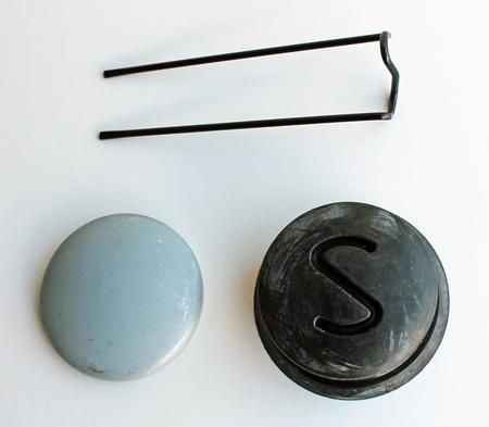

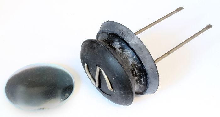

This picture is of a 38. I don't know how it translate to a 32 but from what I gather it should be similar. The attached picture is the "wheel opening" meaning the opening in the center of the steering wheel. In the same image you see two holes at 11 o'clock and 5 o'clock. Those are the holes the "S" wire legs pass though. The lip on the horn button grommet fits into a groove in the steering wheel opening. The grommet acts to hold the 'button/grommet/S wire assembly' in place in the opening AND it also acts like a spring by pulling the "S" wire back after you honk the horn. When you press the horn button it forces the legs of the S wire into the holes where the tips of the wires contact a brass/copper ring on the mast jacket bushing. In theory the shaft of the S wire leg(s) will contact the edge of the hole(s) located at 11 and 5 in the photo at the same time which completes the electrical circuit and allows the horn(s) to honk. This shows what the S wire/button/grommet assembly looks like.
The opening is the depression in the center of the wheel that the decorative cup fits into. Appears that you have the correct parts.

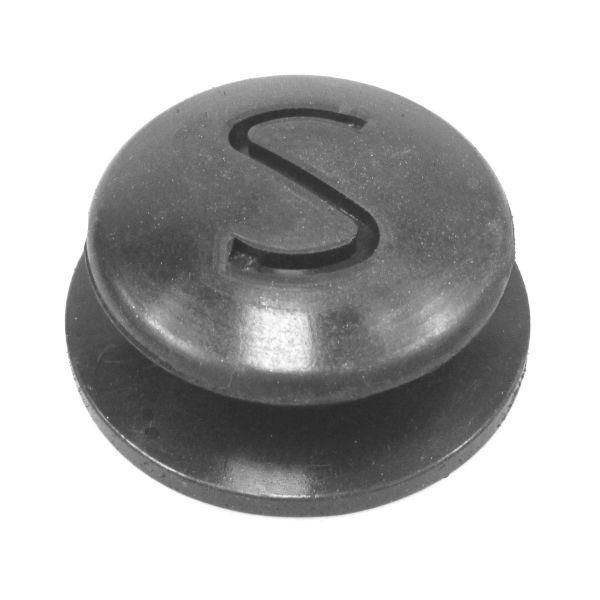

fews parts of the horn
the mast bushing, inside the steering column with wire to horn

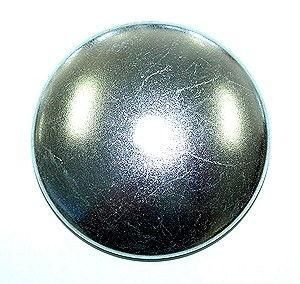

the cap, the one o bought was plain steel, nothing fancy, my 1929 is painted black
rubber with S cut, the s wire (thick like coat hanger) fits in here, and then the cap goes on)
trim ring/cup goes in the steering wheel opening, then rubber/s-wire/cap assembly go in .
