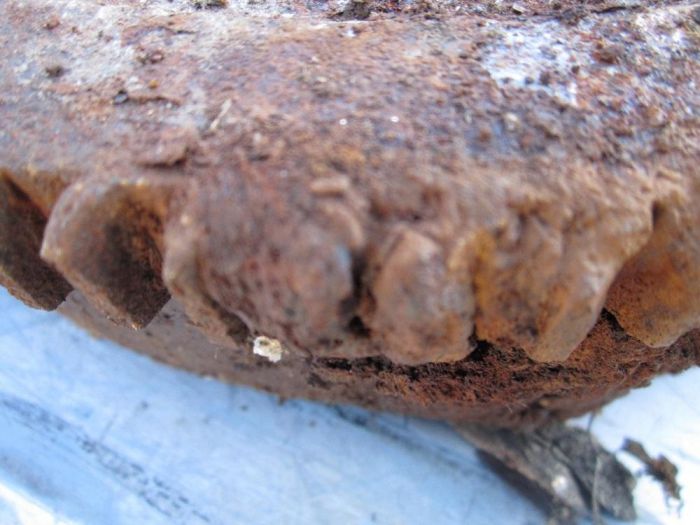

Looks like I will need 2. I count 110 teeth and OD of 14 inchs. Who sells that? Thanks

Take the ring gear of and put it back inside out. Grind of the teeth outside as original
Try Elwyn "Al" Suehring from Wisconsin al@suehring.com He is the flywheel ring gear guru. https://www.suehring.com/
He should have them in stock.

Well P1 flywheel rough, may sandblast and see what happens. P2 motor out, still stuck and white powder in #4???? Brakes on P2 after steam.
IMG_0857.JPG IMG_0858.JPG IMG_0859.JPG IMG_0860.JPG IMG_0861.JPG IMG_0862.JPG
Maybe the mouse that was found in the water jacket got lost after doing a line of cocaine in cylinder 4.
The only other thing I can think of is corrosion if the piston is aluminum.
;-) Dean
