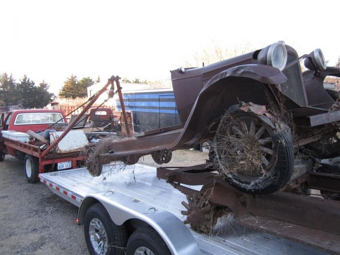

To keep things straight. LP is the original 28 1 ton we are trying to keep near original (by popular demand) so I have a "hall pass" on this site to build a hooptie from the remains.. P1 (pile one) will be the donor truck on front of the trailer loaded in Kansas 22 degree weather. P2 (pile two) will be the donor truck mounting P1. What is the average Chevy litter size? Today was unload both and start disassembly of P1. Decades of Kansas dust and weather left no wood usable but the metal and frames are in solid shape. Of course EVERYTHING is stuck and tons of dirt. So far we have decided P1 will be the hillbilly truck as the tree grown around the frame will be custom carved and part of the build (love my job!). AND IT HAS A TITLE in sellers name. Here are day 1 loading and today parting out. Looks like motor and tranny have to come out as a unit. Back to the shop. Later.

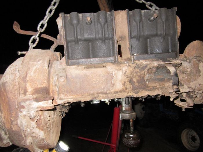

P1 motor a rebuildable core at best. Cam is flat but scored a nice pan, correct pickup filter, correct fasteners etc for LP. We think P1 was a stake bed with running board vertical flaps. Motor tranny out but still stuck. I bet bearings are toast but the block has little or no wear in cylinders. Done for the night. Stephen

Fired up the steam cleaner before shower time but dogs not helping. Bust engine down in AM.

I am not a 4 cyl guy but from what I see of the insides looks really good. No bones in there so can't blame the dogs for lack of interest.

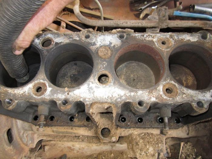

We found JIMMY HOFFA!!!! He was stuck in P1 bell housing SO that is why the motor was stuck. Cam is good so that means it must have bent rocker arms or something in valve train. 4 stuck valves, Boyd cleaned it and reworked it but still will use as a core. The motor spins nice and has a clean bottom end. Cleaner than the running LP. Pics tonight.

Air compressor in shed never sounded right after Laura and it quit on the dirtiest project in history. There was a mouse skeleton in the water jacket of the head! Had to come thru top of radiator and tunnel into the engine. Hoffa, Scarecrow, Tinman, Lion, Dorothy, all in P1. Who will be in P2? BUT cam is fine and lower motor cleaner than LP. So we will break it down and hone etc. The vac tank even worked but still having Chipper rebuild. Also moved P2 headlights crosseyed over to P1. Clampett look. SLH

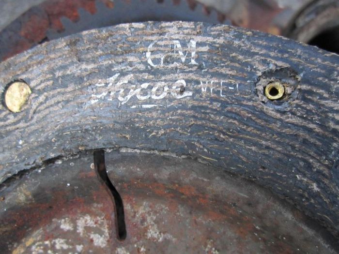

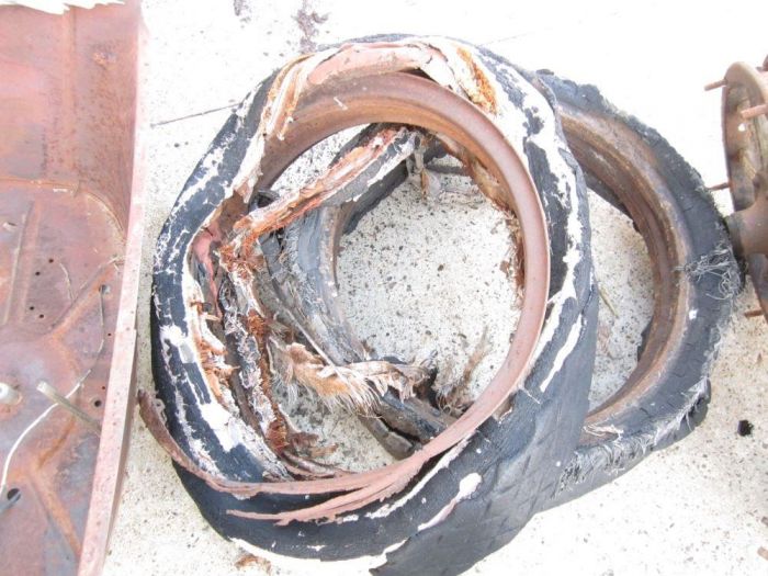

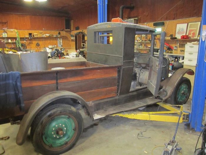

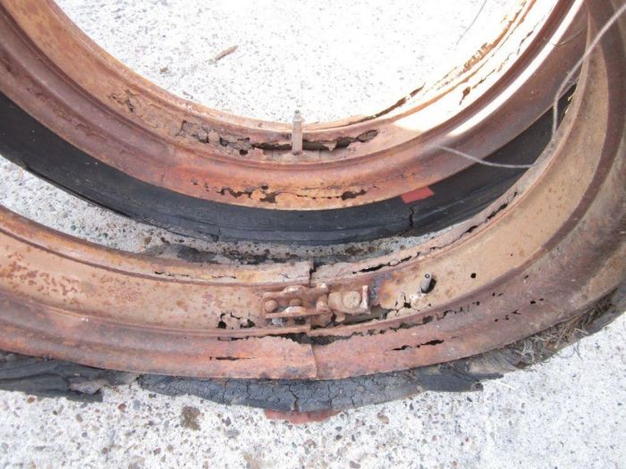

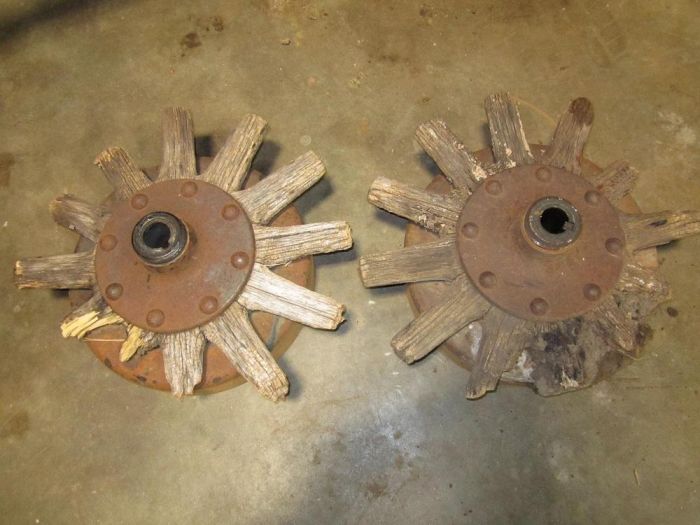

Today was a slower pace as help had to go to paying job. Started on P2 (pile 2) : Good: cowl light lense, 37k miles showing and top of motor looks great, front spoke wheels and 2 piece bearings good. Dry spokes but will try to soak. Bad: not one split rim is good. Rear seal leaked and goo all over that brake system passenger side. Try to pull cowl and motor tomorrow. P1 motor looks good as well and have 2 rims that could be welded. What kind of grease fittings are these? Found a telegraph insulator. Money? How about that heater flap. Patent pending?????

Lurch's rear brakes looked like that too. After I cleaned up the brake area, I replaced the outer felt bearing seals with neoprene ones: SKF 16406. That prevented any bearing grease getting into the brake area. The new seals fit nicely inside the original seal housing plates.
I did not bother to pull and replace the inner axle bearing seals. Okay, I'm lazy. The original ones (felt) are still in there. I don't care if a little bearing grease leaks into the differential area and mixes with the oil.
Then again, I only drive Lurch less than 200 miles per year. If I drove him more, I might be motivated to mess with the inner seals too. Maybe not. ;-)
Regarding the strange grease fittings. They are called Alemite grease fittings. You can get an adapter that has a zerk fitting on one end and the Alemite female fitting on the other. I think Chevy changed from Alemite fittings to zerk fittings sometime in the early 1930s.

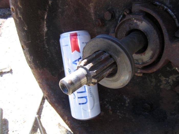

Thanks for the info. After learning about design as I pulled the wheels off P2, the easiest path for a parade hillybilly truck is to run the original drivetrain/suspension. We have an abundance of parts to clean and use on both LP and P1HB. THEN we can weld/rig Iron Duke modern suspension on P2. A single keyway on a tapered rear shaft would likely fail if you put a 140HP motor in there. Just as I was warned on my first day here. Glad I joined here instead of Stovebolt etc. Saved my life. LOL Stephen

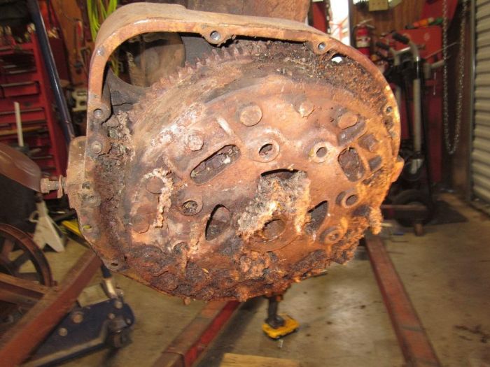

Well I had to come in for lunch and have a beer, maybe 3 or more. All I wanted was a hillbilly truck. I apologize for claiming Jimmy Hoffa was in P1 bell housing. You aint gonna' believe this. I have never pulled an oil pan on a motor that looked like this. Could be the cure for the Kung Flu???? BUT the flywheel teeth are good and will clean. Looks like the throwout bearing is a graphite washer??? So good thing P2 was near free. Guess I will start with a small shovel, then blower (Compresor sill broke) and then the steam cleaner. But the top of the motor looks decent. More tonight. Stephen

Yup, the original throw out bearing is a carbon disk. I have replaced this in both of my trucks with a newer, ball bearing type of bearing that the Filling Station sells. This way, I'm not worried about the carbon disk overheating when the clutch is pressed down for a long-ish period of time.

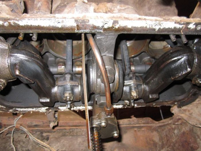

P2 (PILE 2) is living up to its name. Pan rotten, rod bolts rusted, motor still stuck, oil pump & dizzy froze. Using this motor teardown as a research project as P1 motor seems to be a freshen job. Learned that cam gear is fiber and took off a tooth messing around. Crank pully came off (thanks Chipper). Rod bearings had 100 thou spacer and only one had a single brass shim. They still have babbit. Next up is get the cam gears off, crank/cam out etc. Good news is 4 solid but dry spoke wheels, nice flywheel, guages have a shot, front apron metal, lots of brake parts and a nice frame. I guess it was worth hauling home.Clutch pad still has logo and worlds fatest rings! Shop is a wreck.

Had to stop for a little more Laura cleanup but spent a little time at the shop debris field. I see no way to get a cam gear off without destroying it. The P2 motor is still stuck with only 1 piston and the crank out. Will try heat and a pipe wrench to get cam to turn and come out. That one is a mess for sure. Perfect storm, P1 motor had mouse stuff in bellhousing ruining all that, P2 had a complete crankcase of mouse stuff ruining rotating stuff. Betwwen the two, will get a driveline together. Phish

Regarding the cam gear. The cam can be ground with the gear still on. There is enough space between the first lobe and the grinding wheel. These gears are one of the hardest to source items for the fours and early sixes. If at all serviceable its best to leave it on there. Art
