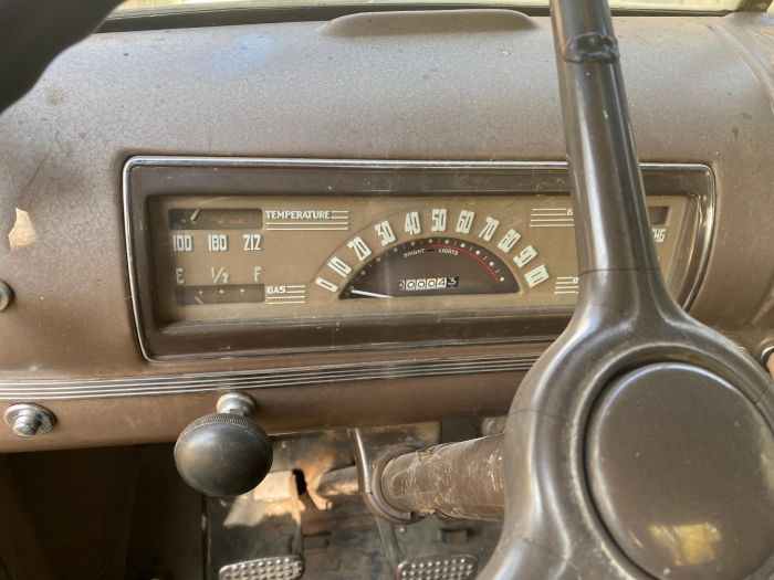

The instrument gauges are painted a tan color (or decal color). What color is the surrounding plate?
Should that be the same as the other painted trim panels and dashboard?
If I'm reading it right, with all cabs from 1940-46 all parts of the cab that were welded together as the cab assembly were painted the exterior color. The screw on panels at the bottom of the door openings were also the exterior color. The floor board and the toe board were painted black. Essentially every other strip and panel attached in the cab and to the inside of the doors was coated with the interior color, which in most cases was the difficult to describe color of "hammer tone" paint. There is no specific mention of the headliner or kick panels, but in my 46 they appear to be the same color as the rest of the interior. They are definitely NOT grey, brown, or black.
Gauges and the trim around them are another matter. I'm pretty sure the 1940's and maybe even the 1941's had a lighter shade of brown on the gauge faces than the later trucks. The trim piece around the gauge cluster I can't help you with, but I'll look at my 46 later.
Hi again I may be wrong but I think the cabs from 1940 to 46 were pretty much the same, and all may have even came from the same plant in Indianapolis. that said, I went out and took a look at my 46 truck and most of what the Jim Carter page says seems to be true. But I noticed a few things.
First, as said before, my gauge faces are the darker shade of brown (yours will be lighter), and the panel they are set in is a lighter brown. The bezel around the gauge cluster has the outer edge chrome (or stainless, not sure) and a broad strip of dark brown matching the gauge faces inside of that. That strip MAY match your gauge color on your truck.

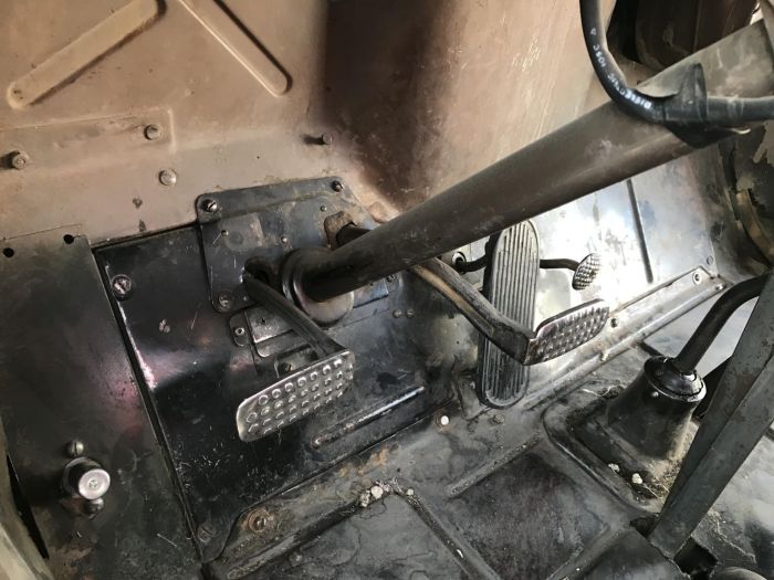

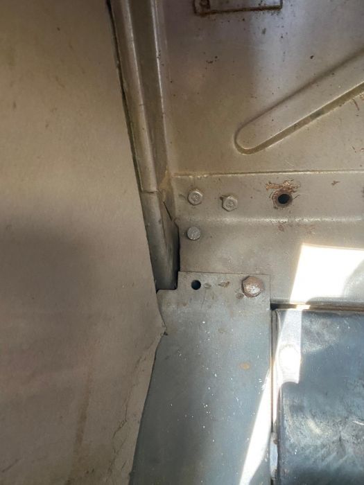

Here's the strange part. Contrary to Jim Carter, the back side of the firewall appears to be lightly sprayed with the same hammer tone paint as the rest of the interior of the cab! It's hard to tell for sure without scrubbing things clean under there and better lighting but I'm pretty sure I can see a light coat of Brewster green covering the inside of the cowl area and behind the kick panels, with the hammer tone lightly sprayed on the firewall with overspray onto the green around the edges that are beyond where you can see without actually crawling in to look. If you'd like, I can crawl in there with some polishing compound to verify once farming slows down a bit, but this may be peculiar to the later cabs anyway.

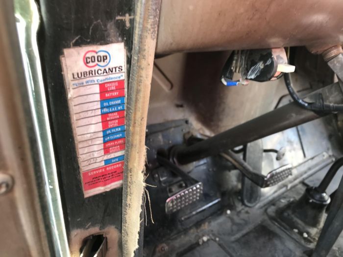

Hello again I took a few pictures of my 46 interior (excuse the dirt, grime and rust... it's pretty much untouched). Hopefully you can see the color of the firewall and the over spray onto the green in the lower left corner of the cab. Also the color of the headliner and kick panels. And the colors on my gauge cluster.
And here is one showing the steering column and support (yes I just replaced the speedometer), and one showing clearly how the doors etc are green, but the panels screwed on are interior color. Apparently they were painted laying flat and installed later.

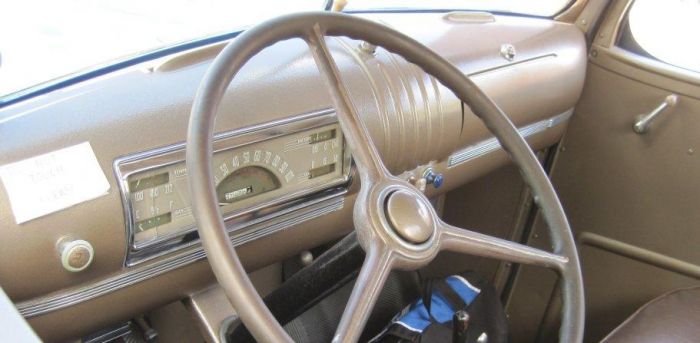

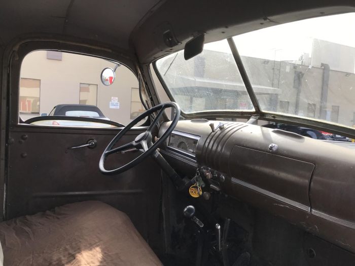

I also found pictures on this page: https://bringatrailer.com/listing/1946-chevrolet-6400/ of what appears to be a mostly unmolested 2 ton that seem to verify the originality of the paint on my truck. I hope I'm not breaking any rules by posting a couple of the pictures (at least I'm acknowledging where they came from). A couple of notable differences: The bezel around the gauges doesn't have the brown strip. And the steering wheel, column and support appear to be flat black. Mine are brown.
Maybe someone with more knowledge than me can please weigh in on these differences?
And finally... I found this: http://classicoldcars.net/1940-chevrolet-truck/photos.htm I can't say how authentic the interior on this truck is for 1940, but the gauge cluster appears to be as I understand it should be. The gauge faces are a lighter shade of brown than later ones like mine, and the brown strip on the bezel matches that color. Hope this helps.
