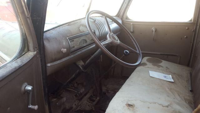

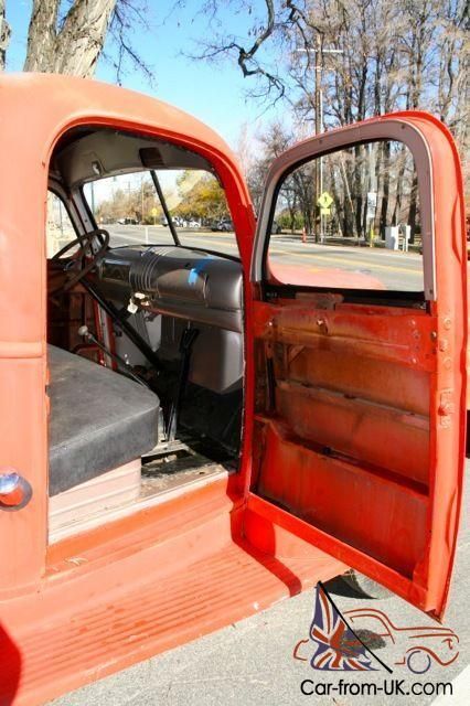

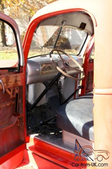

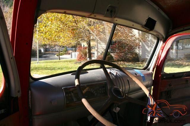

Posted By: Stovblt Re: 1940 Chevy PU Interior - 09/22/20 07:10 PM
I also found pictures on this page: https://bringatrailer.com/listing/1946-chevrolet-6400/
of what appears to be a mostly unmolested 2 ton that seem to verify the originality of the paint on my truck.
I hope I'm not breaking any rules by posting a couple of the pictures (at least I'm acknowledging where they came from).
A couple of notable differences:
The bezel around the gauges doesn't have the brown strip.
And the steering wheel, column and support appear to be flat black. Mine are brown.
Maybe someone with more knowledge than me can please weigh in on these differences?

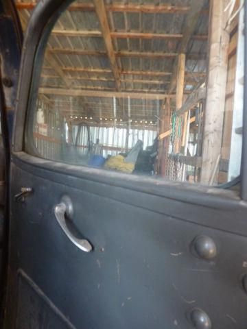

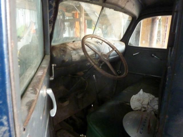

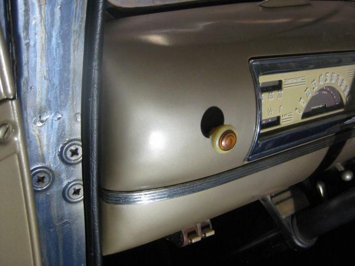

Posted By: Stovblt Re: 1940 Chevy PU Interior - 09/22/20 07:18 PM
And finally...
I found this: http://classicoldcars.net/1940-chevrolet-truck/photos.htm
I can't say how authentic the interior on this truck is for 1940, but the gauge cluster appears to be as I understand it should be.
The gauge faces are a lighter shade of brown than later ones like mine, and the brown strip on the bezel matches that color.
Hope this helps.
