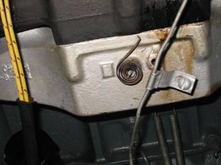

This is the heat riser spring that I need. Don ![[Linked Image from vccachat.org]](https://vccachat.org/gallery/default/medium/1965.jpg)

Still looking for input on where I might find the heat riser spring. Don

I realize this is an old thread but I also need to replace the thermostatic coil spring for the heat riser on my 34 Master. The original one, which is broken, has a few more coils than those currently available. Does anyone know where I can get an original one or will the current replacements for 1937 and newer work?

Brendan,
The 1933-1936 models used part number 837491. I cannot see where it ever crossed. Some years back I purchased 838573 from a Chev. dealership and it has worked really well on my 1933 Master model. I don't remember if they told me it was a cross or not. The 1937-40 part number was 838561 which later crossed to the 878573 so the 1937 replacements should work OK.

Thank you for the information. I was able to bend a new tab in the center coil of my original spring and reinstall it. I tested it with a propane torch a couple times and it worked fine. I intend to keep an eye on it in case breaks (and it probably will) again. In the mean time, I intend to order a later replacement and have it on hand.
