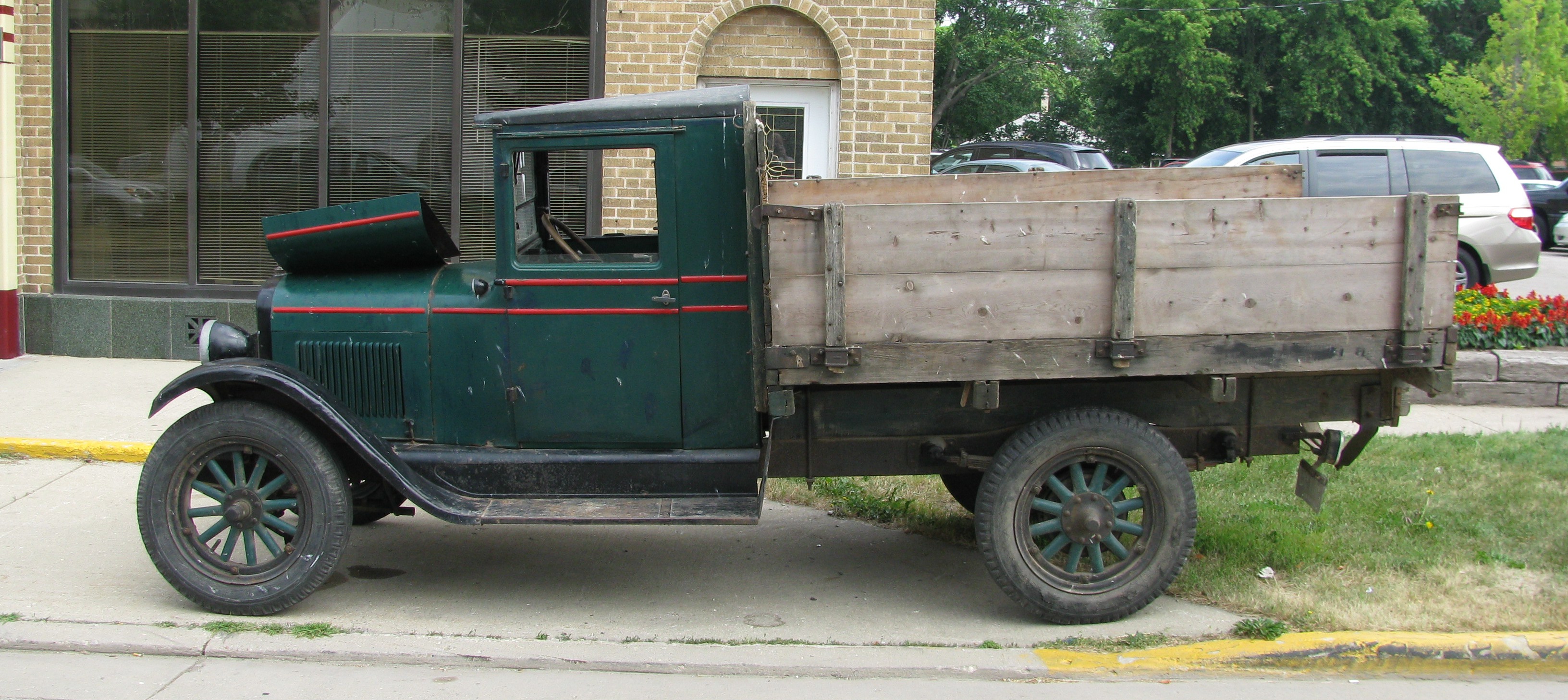

Hi Dean,
I was able to find a number on the engine T332033. where might I find the car ID plate?
Im having difficulty uploading a picture to this thread, dont know if Im doing something wrong?
I did find pictures of my truck on the internet while looking for information. This is a picture of my actual truck. I dont know how or why they photographed and published it but here it is
http://www.carsandracingstuff.com/library/c/carstimeforgot_2011photos03.php
http://www.carsandracingstuff.com/library/c/chevrolet080.jpg
My uncle was very proud of this truck but unfortunately he is now not in any condition to give us any information. I now wish I would have asked, but never thought Id buy it either.
Thank you for any information you might be able to tell me.

Hi Barbj,
Great looking truck! From the pictures, I can tell you a few things about it:
1. I believe it is a 1927 Model LM 1 ton truck. The number of spokes on the wheels, the front profile of the radiator shell, the shape of the headlights, the headlight rims, and the fact that does not have brakes on the front wheels are all clues.
2. The engine block looks to be from 1927 because it does not have ribs for the pushrod covers, which were only in 1928. Since the engine block is not from 1928, this supports my theory of the whole truck being from 1927.
3. The engine head is from 1928 because of the two exhaust ports. The exhaust manifold is an aftermarket manifold that would've had sheet metal around it and fed hot air to a heat vent in the cab.
4. I think the cab is a stock cab made by Chevrolet.
5. The transmission is a 3 speed, which was standard for 1927. The lack of a reverse lockout lever is the clue. A 4-speed (which has the reverse lockout lever) was optional in '27 and standard for '28.
As for the ID plate, it might be nailed on the passenger side of the wood box that encircles the gas tank and also is the seat bottom support. When you open the passenger door, the ID plate should be in plain sight.
If the truck is in the same shape as in the photos, you are starting with a great, near stock truck! My druthers would to fix it mechaically, recover the seat, and drive it AS IS. It's only original once.
Being a 1 ton truck, it will go slower than the cars because of the high gear ratio in the rear axle. That's okay because this beast will not stop on a dime.
How do I know all this stuff? I have one! Although mine, Lurch, is nowhere near as in good shape as yours!

THANK YOU Dean, This is exactly the type of information I was looking for! Im so happy to just know this.
I found the ID plate and it seems to confirm what you indicated. it reads "Manufactured by Chevrolet Motor Company division of General Motor Corporation. when writing mention Model CAPITAL car number 21LM 6911 carrying capacity 2000lbs"
The truck is about in the same condition, but had a lot more pigeon poop on it when I bought it. My uncle last ran it about 6-8 years ago. When it was going to go up for auction it wouldnt start, some friends of my uncles did a few "short cuts/bypasses" to get it to run just for the auction(not permanent). I am now trying to fix the problems.
mechanically this is what I know so far that needs repair.
1.needs all new tires,one will not hold any air
2.its leaking oil from the head gasket, The only gasket set Ive come across so far is "1927 » Chevrolet » AA Capitol 171-4cyl 103wb" Do you know if this will fit?
3.the radiator has a small leak,
4.a problem with the wiring, lights wont work and they had to run a wire direct from the battery to the thing just to the right of the distributor to get it started. (sorry Im not a mechanic and I havent gotten to that thing yet to learn what it is)dont laugh too hard. :)
5. Vacuum tank would not feed the carb. I couldnt find anything wrong with it, but there was a little, very little dirt in it. the valve under it was closed off though and possibly it needed a little prime? They hung a tank from the side of the truck so the carb would be feed by gravity.
6. Is there suppose to be a casket on the valve cover? or just that pad on the valves? or both? Mine just has the pad.
The upholstery is in rough shape, as you can see from the pictures. I would like to get that replaced but am not sure what type of material it is, it appears to be like a vinyl.

Hi again,
More info about your truck. The car number (21LM 6911) does indeed confirm it is a 1927 LM.
The '21' means that it was assembled at the Janesville, WI plant. The '6911' means that the truck was number 5910 off the assembly line. The first off the assembly line was numbered 1001.

I never expected to be able to find out this much information, this is great. Thank you.
I believe the original color was green as there is traces of it in the grain of the original wood. I believe the cab was repainted, but may have originally been green also.
DO you know what color the engine block would have been painted or if it was painted?
