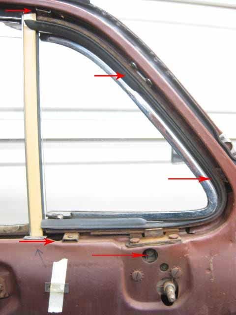

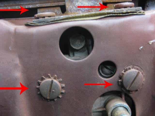

Here are a couple of pictures to ID what you are getting into. I am assuming you removed the garnish around the window and the upholstery panel on the door. The first picture shows red arrows pointing to the screws you will need to remove. I always choose a screw driver with the largest head that will fit snugly into the screw head. I lightly tape on the handle of the screw driver with a hammer to loosen the rusted bond between the screw and its surrounding hole. I then try to turn the screw out of its hole using maximum pushing force. Once the screw moves I then tighten it and loosen it to gradually work it out. The bottom center red arrow points to a bolt that must be removed to get the window frame to come out of its regulator. Likewise, I only use a socket that corresponds to the number of sides of the bolt (6).

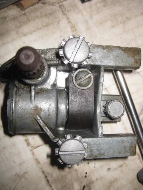

Remove the four large screws that hold the regulator in place and carefully pry the shaft out of the regulator. Remove these screws using a very large tipped screwdriver. Any screw or bolt that you could have sprayed with PB Blaster or a penetrating oil you should. Try to let it sit for 15 minutes and then respray it (screw, bolt, nut).
