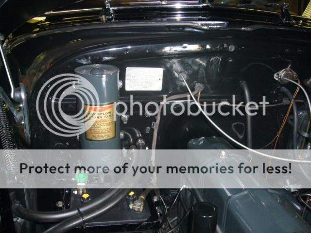

I followed the instruction as stated and all worked well..I would also question cutting the over flow pipe but I did as instructed ![[Linked Image from i563.photobucket.com]](http://i563.photobucket.com/albums/ss79/chefchevy/Overflow%20tank/P1000526.jpg) ![[Linked Image from i563.photobucket.com]](http://i563.photobucket.com/albums/ss79/chefchevy/Overflow%20tank/scan0003-2.jpg)

Nice & neat firewall Bruce. I see you have not painted your battery caps yet. Is that the new battery you sent for ? How did it work out for you ? I see you also have windshield washers. Have you put water in and tried it? The first time I used mine it took me a while to figure out how to get them to stop spraying water. I finally woke up that I had to turn the wiper valve off momentarily to break the vacuum. I just sent you a PM

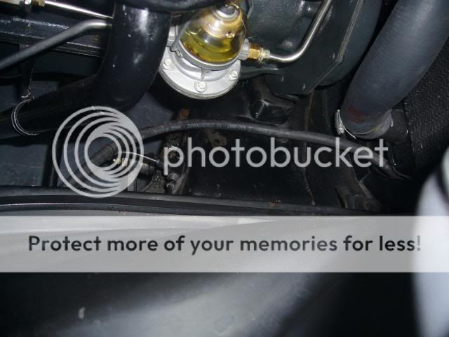

Alan,I did just as you suggested,just route it down the support and out the bottom..Here mine routed towards the tank ![[Linked Image from i563.photobucket.com]](http://i563.photobucket.com/albums/ss79/chefchevy/Overflow%20tank/OverflowTankHoseB.jpg) ![[Linked Image from i563.photobucket.com]](http://i563.photobucket.com/albums/ss79/chefchevy/Overflow%20tank/P1000666.jpg)

Thanks Chef-Chevy for the pictures. Looks like about the only way to get the tube out of the radiator support. Thanks again, Alan
