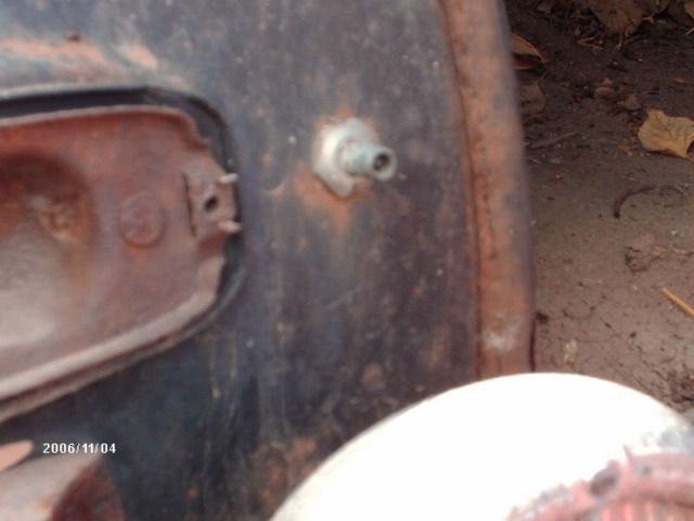

In another thread we were talking about the accessory spare tire monitor. It's a hose that attaches to the valve on the spare so that air can be added, or pressure monitored without taking the spare from the trunk. I had stated that the other end of the hose comes out someplace like below the rear bumper, but then found this photo on the Chevybombs website. Is this the correctly installed accessory? ![[Linked Image from i150.photobucket.com]](http://i150.photobucket.com/albums/s84/brewsterg6/My%201951%20Chevrolet/spareair.jpg)

Proper position...But, I've only seen them on the left (driver's) side...I mean...That's where the tire is...Anyway...
Yeah...Haven't seen this accessory for sale on EBay, for a while...Are you looking for one...?

Not looking for one... Just wanted to correct the error in my post on the other thread. I started a new thread because we got off topic on the old one. The accessory was for '40-'41, so I guess you '37-'38 guys are stuck with your little hole. Kevin is right, it's so you didn't have to open the trunk. Now was it dealer installed? If we were judging at a show, how would we mark the location of the outer end? Would either a lefty or a righty get a deduction, or were dealers sticking them where ever they wanted too?
