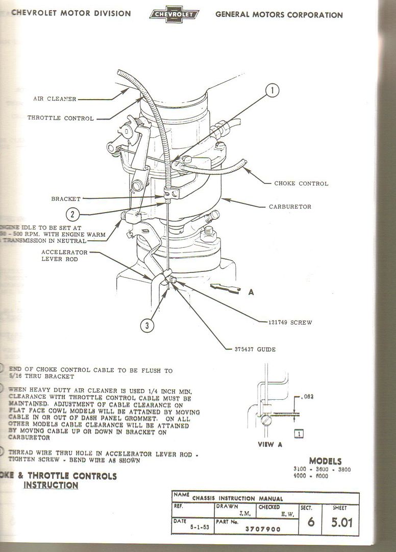

'54 truck 235 / Rochester "B" throttle and choke bracket and connection:
< CLICK >
- Lonnie

That link worked for me and the diagram was awesome, looks like the picture Tiny posted.
Check out this one last image. The blue arrow is where I need to move the bracket up to. The yellow arrow is the wire that needs to go down through the throttle. The problem is there is no screw piece (like on the choke) to hold it in. It doesn't appear that anything is broken off on my throttle but may need further inspection.
I could try putting the wire down through with the cotter pin or through the washer. Might be a little rigged up.
For a cold start it seems like the choke is what I am lacking the most. I could also leave the throttle unhooked.
