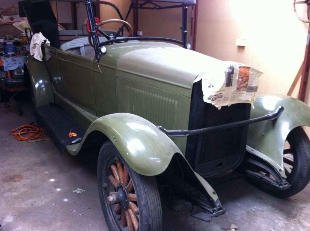

My wife and I have two 1928 Chev AB's now... And it seems the one we just bought to restore is "1928ChevTourer"s car as pictured in this thread. It's essentially unchanged from what you see here but we have some significant plans for it. We bought it from what I understood to be a dealer/collector in Adelaide late last year.

We have 2, the car which is the subject of this thread and another 1928 AB Tourer that was converted to a ute in the '30's... We have a lot of work to do on both and a lot to learn, but we are committed and excited about getting them both restored and on the road
Here is the car from this thread as it currently is...[Linked Image from i749.photobucket.com]

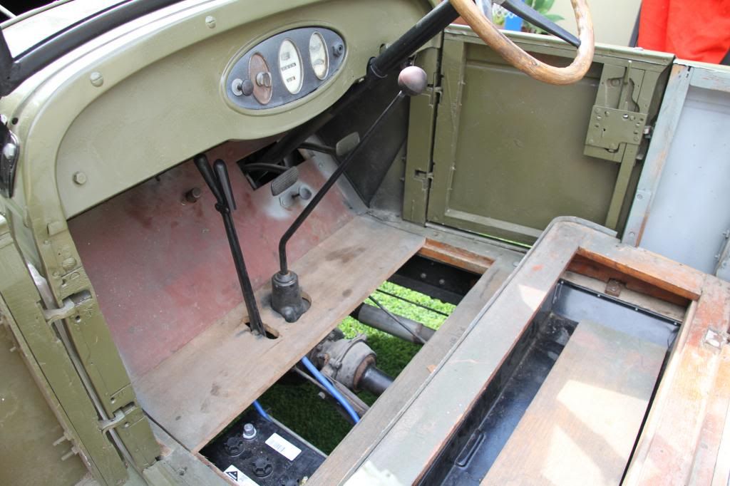

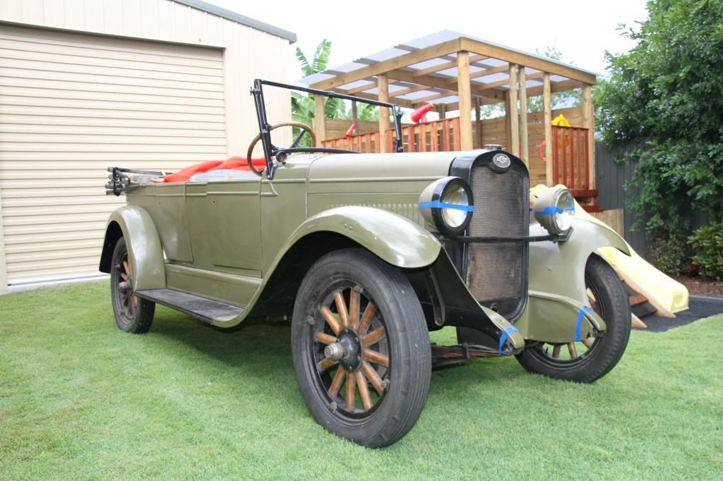

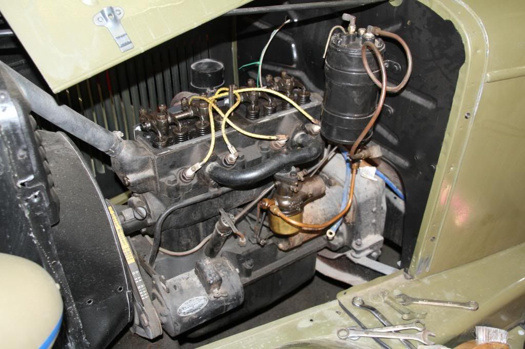

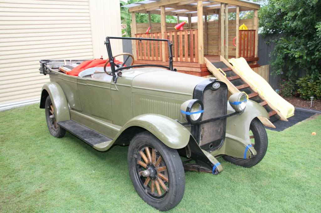

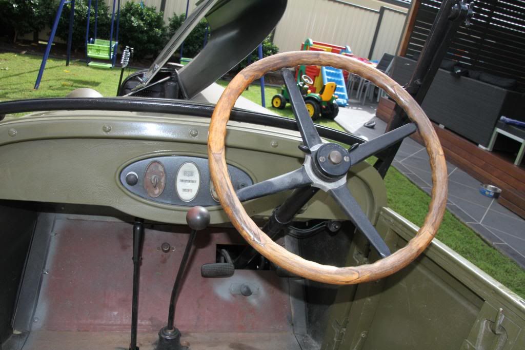

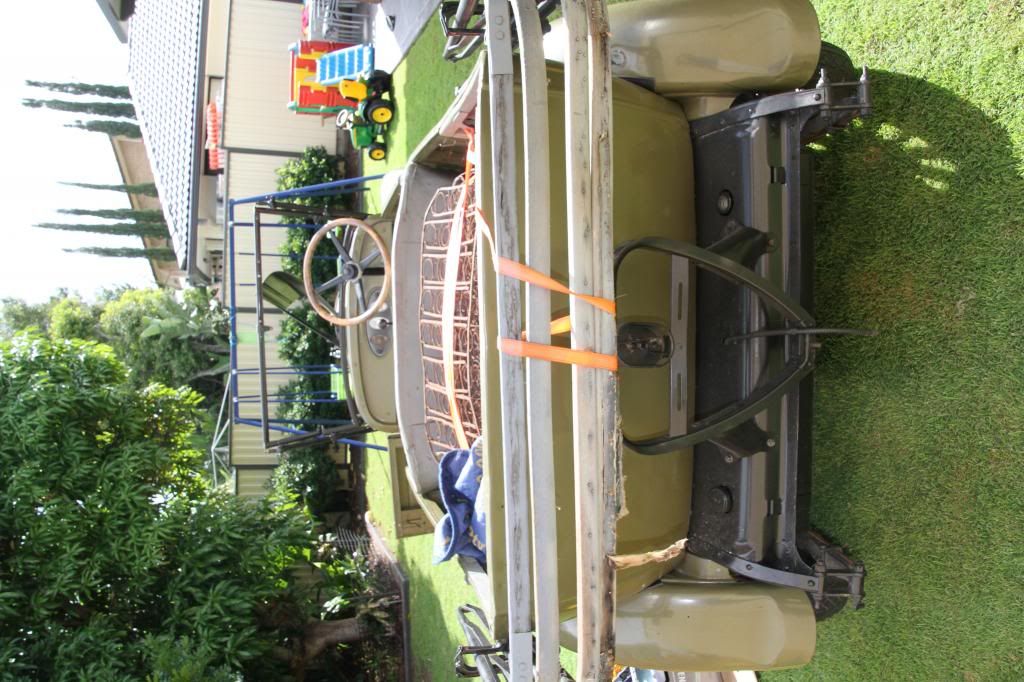

And a few other photos... If anyone knows the original owner (or last one) we would love to get in touch to learn more about this car and what's been done etc... Have sent the forum user a pm a few weeks back but no reply (nor has it been read) at this point:
