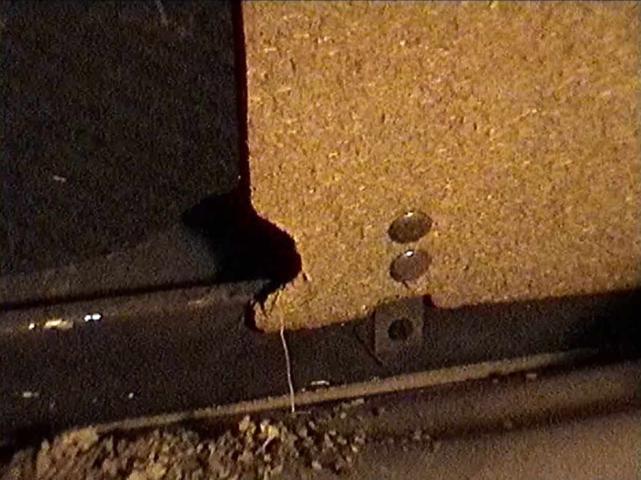

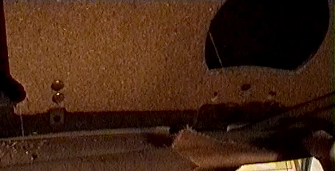

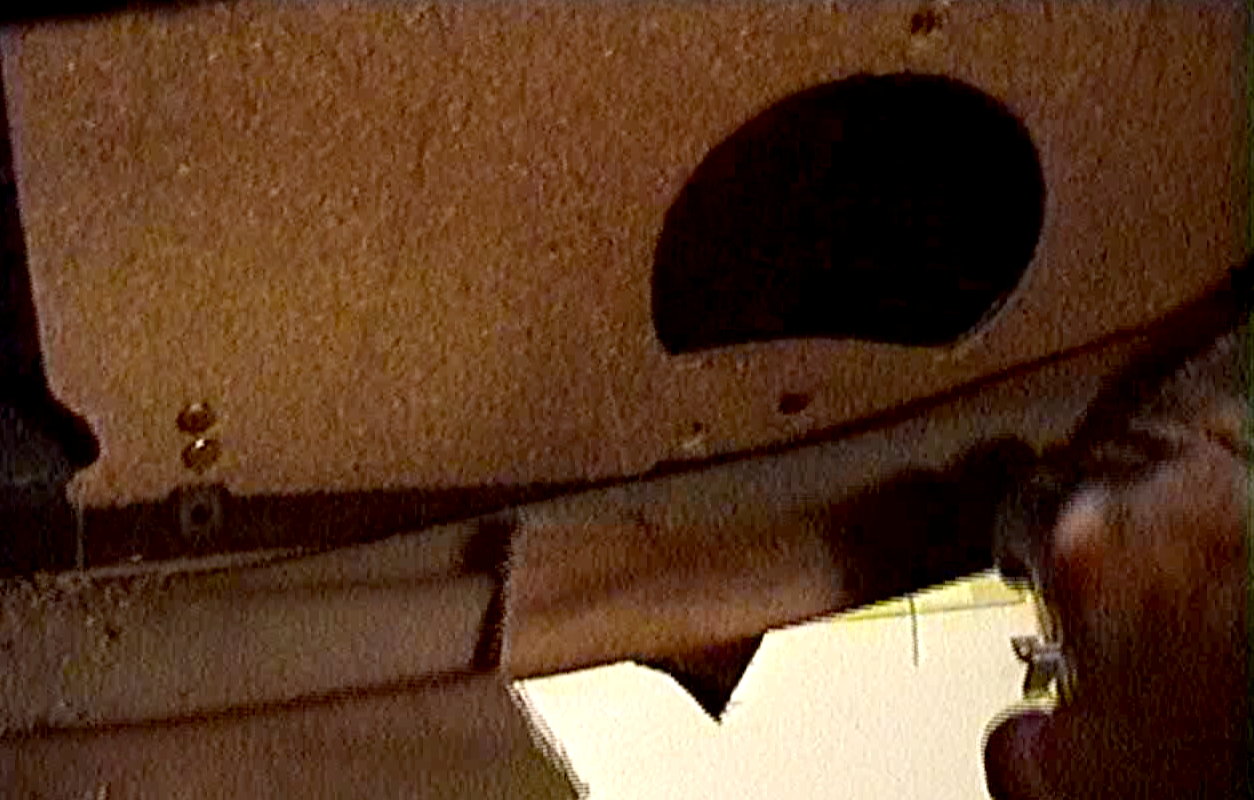

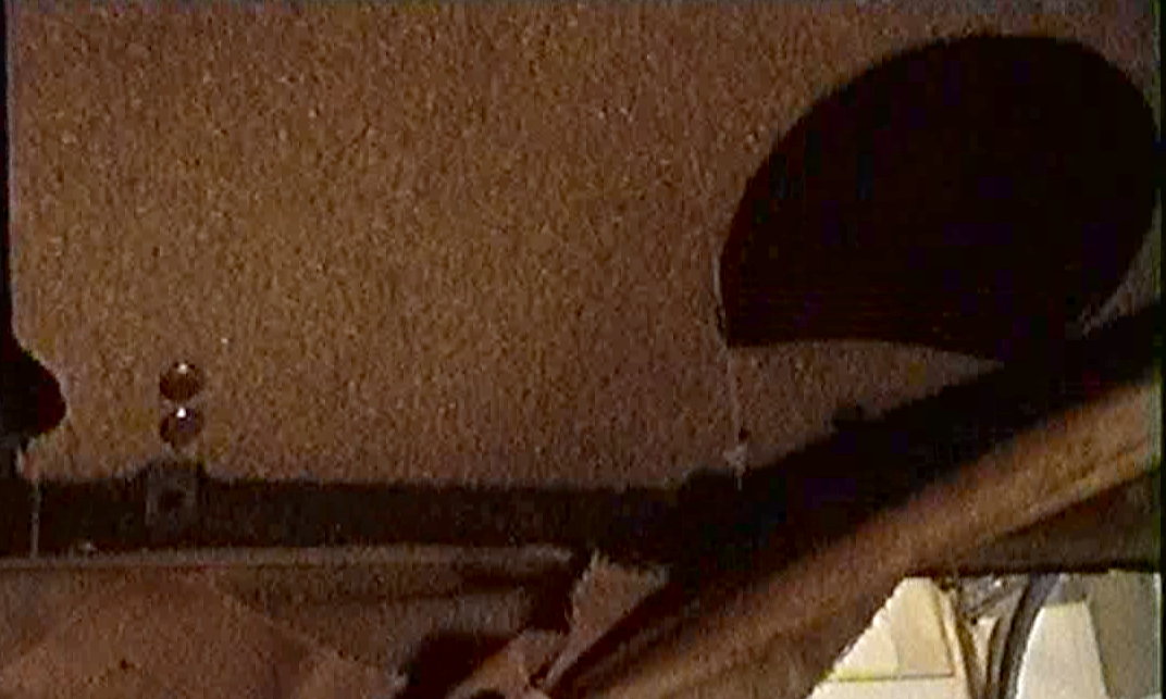

On my 37 there was a fibre board in that area it was rivited to that part closest to the wind shield and on the other side it fit in the "U" shaped area on those rear brackets and was rivited also I think the speaker bolted to the fibre board

These pictures show the '38 roof speaker. I think all '38 closed bodies should have a speaker wire running up the drivers side front cowl post and across the roof near the windshield to the front center for use with this speaker. The roof speaker was used only with this Six Tube Superheterodyne Radio model, out of the 4 radio models available in '38. I believe there may have been a coarse grey screen or cloth covering the center dome of the speaker area. The 2 radio models that used cowl speakers, had a covering like that. Those cowl speakers were similar to the roof speaker except completely circular and thicker. ![[Linked Image from i27.photobucket.com]](http://i27.photobucket.com/albums/c169/hayre/38roofradiospeakerresized50.jpg) ![[Linked Image from i27.photobucket.com]](http://i27.photobucket.com/albums/c169/hayre/38chevspeakerroofresized50.jpg)
