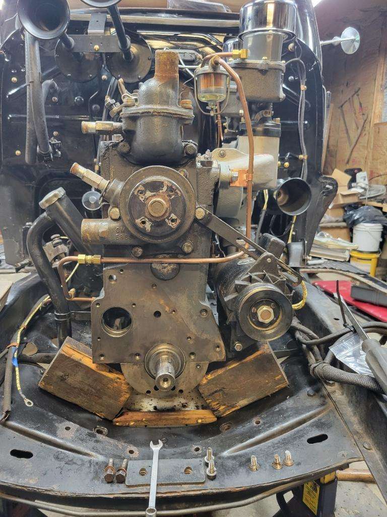

The worst leak was at the front of the engine, between the engine mount plate and the block. The counter sunk screws were snug, not tight, so the gasket between the engine and mount plate was damaged. Had to drop the pan, unbolt the timing cover and remove the cam and pull the crank gear to to remove the mount plate. ( added a photo but don't know if it will show)
