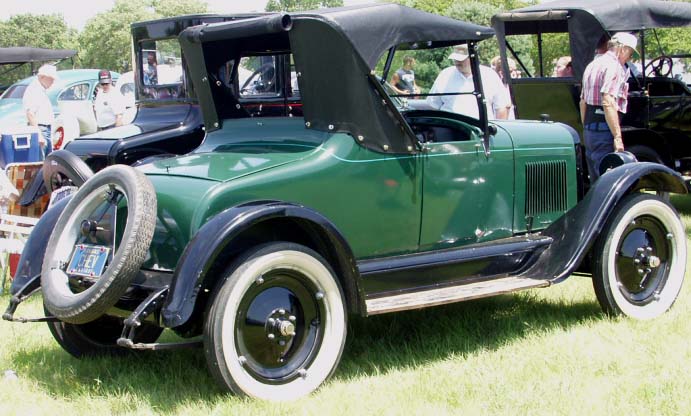

Is this a Rumble seat Roadster? ![[Linked Image from carnut.com]](http://www.carnut.com/show/04/all/all201.jpg) What are the production figures on these compared to the standard roadster with a trunk? ![[Linked Image from img.photobucket.com]](http://img.photobucket.com/albums/v605/jimmyschev/29%20Chev/49_voit3quartarr.jpg) Cheers Jimmy

the answer to the top picture is no . as to the production numbers it is one as this car is a 23- 24- 25 -26 - 27- 28 automobile it was put together for a tour in two days and has ben driven on several tours in the us. the bottom car looks like a late 26 roadster no rumble seat only trunk it was the first roadster pickup as a box was available . take the two screws out of the trunk take the lid off slide the box in . there are two pads on the top to fasten the box in . they came in green and black fenders hope this helps

Hi, The first picture is an early 1925 Roadster. It appears to have several errors in the restoration. Back curtain, stripe, color, key mounted in trunk lid, wheels, are just a few that are obvious. It is NOT a rumble seat car. None were made in 1925. The second car is a 1926 roadster. It is NOT a rumble seat car. It also has errors, but is more accurate than the 1925. Rumble seat was not available until 1927. Now that I have said all that, I must hedge my bet with a statement. My comments apply to US models and some of the items may be unique to export models.

Hey, Push, that isn't fair, You had insider knowledge about that car, I thought I recognized the tall guy in the first picture.

ray the trunk key is left in the trunk so that the owner does not have to find it every time he raises the trunk . i made it out of the end of a wood bit the taper fits and it works was pressed for time and the owner needed to get in the trunk to store his shinner bock
