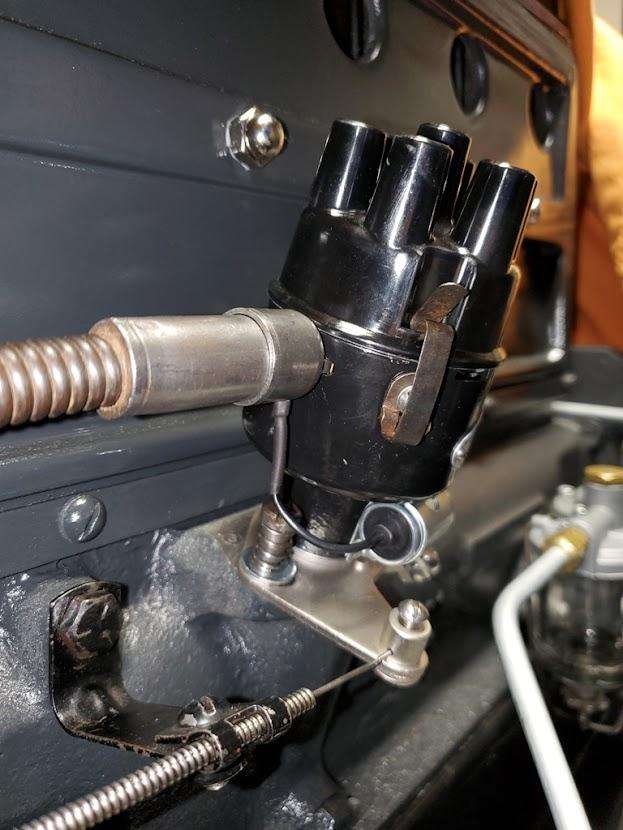

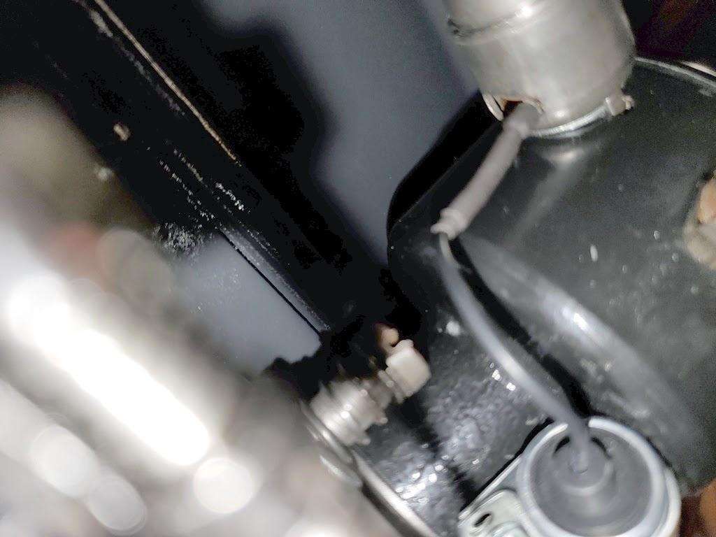

Are you referring to the spring on the screw that goes into the boss on the block on the arm ??
if so it is part no 821599 it is a simple compression spring nothing fancy i can measure one on my car if needed.
below are a few picts for reference.
sure Chipper or someone may have one if you want an authentic one wink
I suggest going to your local hardware store and finding a spring that will fit.

Here it is . 1/2" tall

It is a shoulder bolt made special by GM for this application. A washer with a inner diameter a little larger then shoulder would go under spring. When bolt is tightened down againist the block it puts a little spring tension on distributor clamp and still let it move to advance timing.
