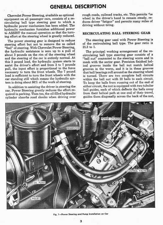

. Francis W. Davis, an engineer of the truck division of Pierce-Arrow, began exploring how steering could be made easier, and in 1926 invented and demonstrated the first practical power steering system. He asked so much that US auto manufacturers waited till his patent expired in 1953 to offer it on mass. .
. The 1953 accessory power steering is a bolt in for your 1950 PG. That's the closest to "Original Equipment" you'll be able to get. If you find a rack and pinion that is the same width as your tie rod, that will give a more positive feel than the sloppy center arm system. .
, I've posted some pictures of the 53 system to view. .
