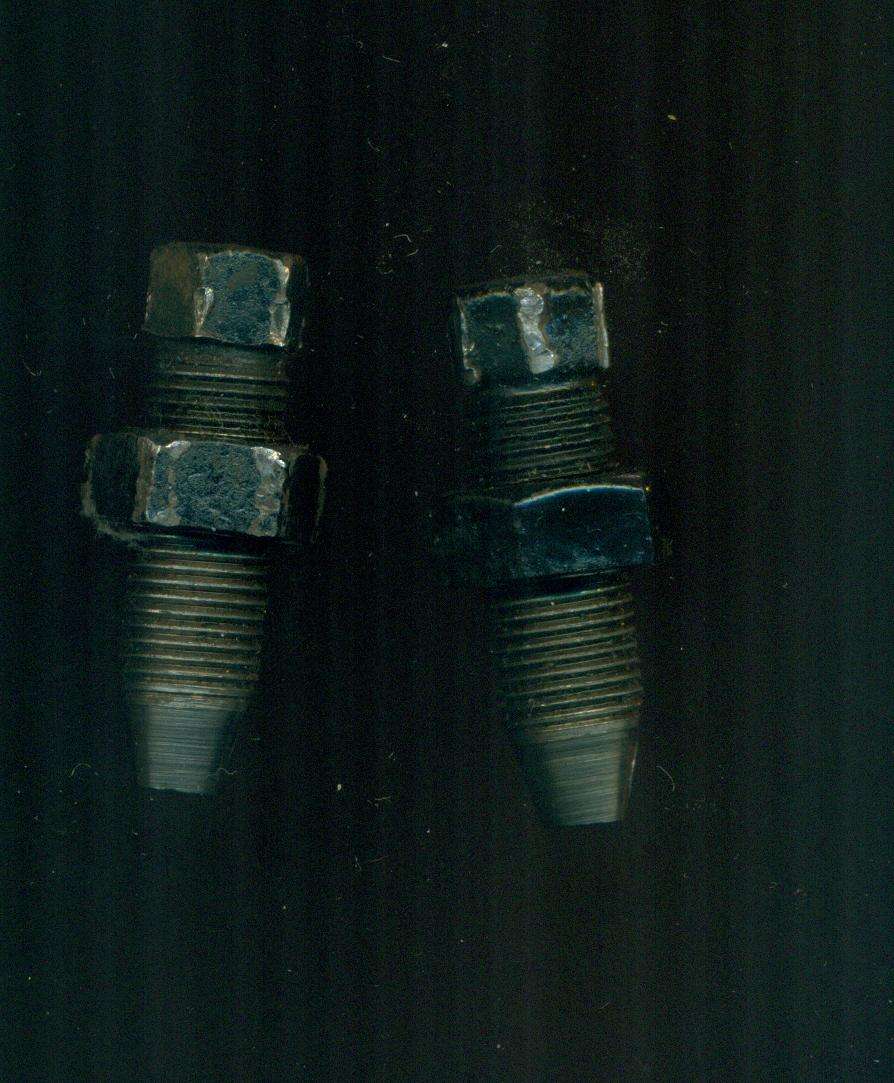

On the rear end differential pumpkin, I removed the fill plug, and as directed removed these two, what I thought were fill and drain plugs from the small housing behind the pumpkin where the drive shaft is connected. Obviously they screw into something inside the housing with the tappered ends. The one was frozen on the screw part when it came out so I'm assuming that is how it should go back in. I'm guessing the sane set up with the other screw should be the same. I backed the nut off a bit so the screw could go in far enough until it seated against something, just to see what these held in place???

344084-screw, propeller shaft rear bearing lock
114496-check nut (1/2"-20)
Cheers
good info from Harry there, gotta have the manuals to know what you are looking at, all this info in in the Repair Manual :) Owners Manual has basic info, Master Parts Price List has list and diagrams of most of the parts, what they are called and where they go.
those 2 screws you removed need to go back and stay, they hold internals in place !!

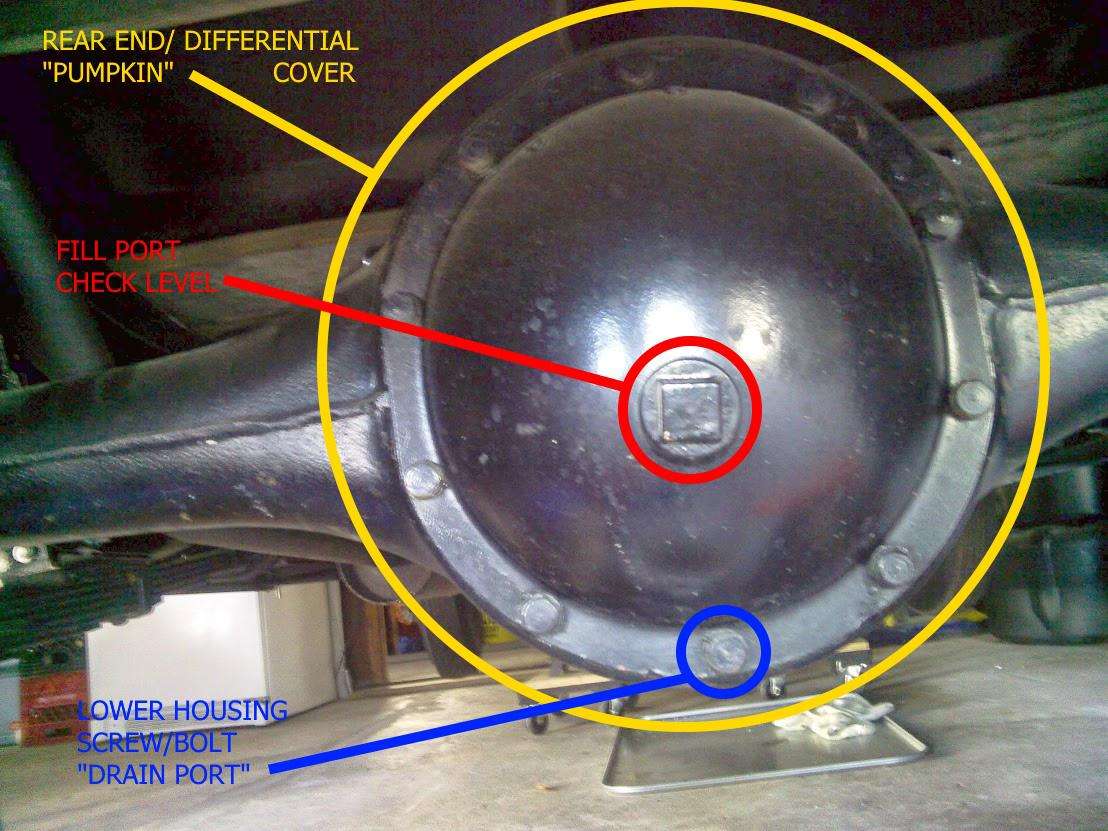

here are some diagrams i threw together
Trans 1
...shows fill/ check port on trans, also notes that the drain is on bottom
Trans 2
...shows where the drain port is on trans (looking from rear of car towards the front)
rear diff - pumpkin
...shows rear end/ differential "pumpkin" cover(looking from rear of car towards the front)
...fill/ check port, and drain bolt/port (it is a regular bolt holding the cover on, bolt holes go through the housing casting into the open area where gears are)

Those two screws hold the pinion bearing in place.

When you replace the tapered screws try to be sure that the tapered ring that holds the pinion bearing in place is in its proper location. It has a tendency to move back when more than one screw is removed. A Phillips screwdriver, small punch or solid rod can be inserted and with probing can locate the ring's position.

I had a feeling that's what those two bolts did. I'll make sure (with a probe) that they go back in the ring. How tight do they have to be? Snug I would think.
