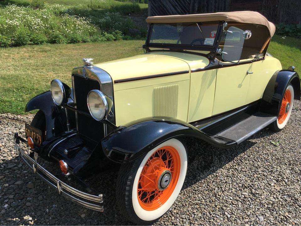

I was going to order some new spark plugs for the 30 Roadster, but noticed the ones on the Filling Station site for 29 thru 32 years, were C 87's and the ones in my car are C 86's. Not sure why the difference? Should I swap out the 86's for 87's? If so what gap. Right now mine are about .030
