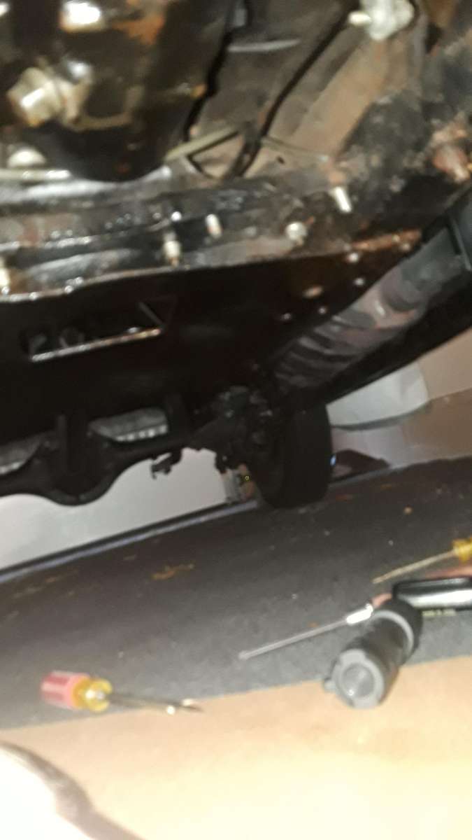

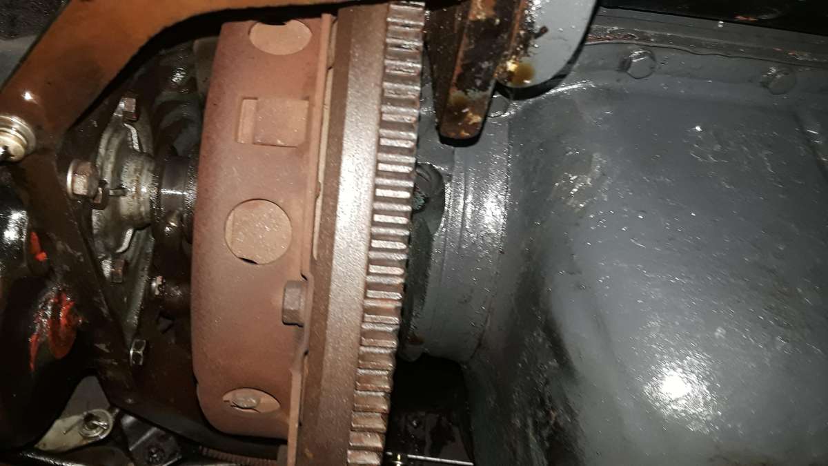

Gene, no cross member behind pan but in from of flywheel housing. Cross member located to rear of rear of trans mounting bolts. Why would it be necessary to tighten rear main bearing and remove shims in order to replace oil seal? (forgive my almost total ignorance on this subject)? Any thoughts on how best to remove trans and deal with torque tube being in the way of sliding trans back out of bell housing?
40ragtop
Do you you think that you could remove the flywheel hoiusing cover without removing anything else? I you could you shoud be able to drop the oil pan OK.
Shims are removed to reduce the bearing clearence which in turn wii reduce the flow of ilo past the bearing.
Can you send me a picture of what it looks like at the rear of the oil pan?

The cross member plate is riveted. Attempting to add photos of bottom of pan but doesn't look like I'm doing in correctly. I see what you mean about the log tie rod needing to be dropped. If I can figure out how to correctly use the attachment manager I'll send a photo of the cross member plate.
[Linked Image from vccachat.org][Linked Image from vccachat.org]

[Linked Image from vccachat.org]Photos of cross member plate. Rectangular hole in plate is for access to emergency brake cable adjustments.

you are all set to remove the oilpan. bana2
