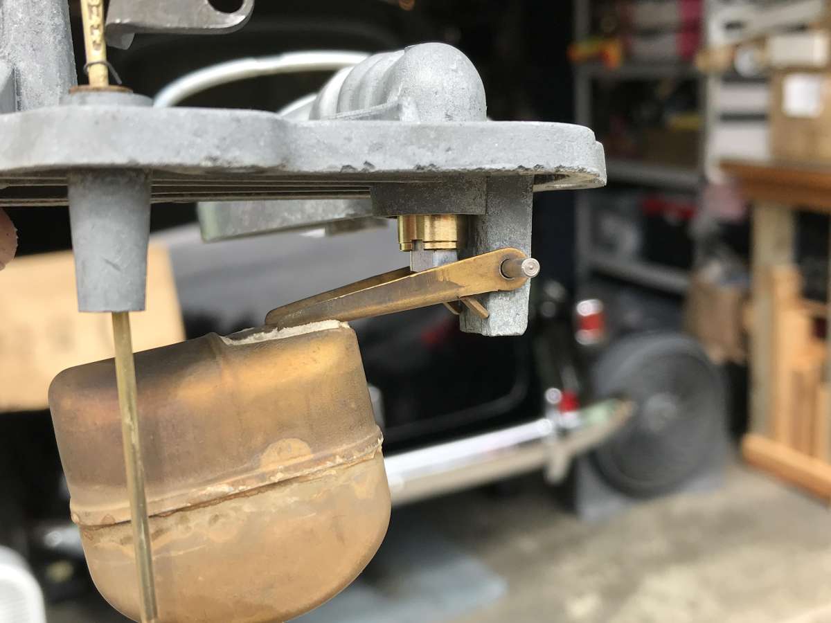

I've had the recently rebuilt Carter W-1 on the vehicle for 5 months and 150 miles without a problem until recently. Now every time, I try to start the engine the fuel pours out the top of the float cover. I have tried tapping the top of the float cover several times in the attempt to unstick the float assuming that it is stuck without success.
I'm seeking advice for the least intrusive way to free the float without having to totally remove the carburetor. If I was to remove the input fuel line, unbolt the fuel bowl cover, lift cover slightly and bolt it back down might it resolve the problem or am I just wishing?

The float bowl cover can be removed by unlinking the bent rod that connects the lower throttle arm to the coordinator (part that rotates to push down the accelerator pump plunger). It is also best to remove the metering rod held on a peg on the coordinator by a thin wire spring assembly. Then remove the U shaped link to the accelerator plunger. Loosen the fuel line fitting and pull back the line. Finally remove the screws that hold the float bowl cover to the cast iron body. You can then lift off the cover to access the needle and seat. May be necessary to pull lightly on the fuel line to remove from the fitting. Once removed you can turn the cover over to see if the needle will move in and out of the seat. You can also blow on the fuel inlet with the cover inverted to see if the needle is seating.
The float is held in place by a small rod or pin. Remove it and while off shake the float to see if there is any liquid inside. If not then clean the needle and seat with a rag or paper towel wet with carburetor cleaner.
Reverse to put back together.

Also clean the arms of the float where they rub against the float pin support of the bowl cover, and the float pin support.
Not uncommon for some sticky residue from evaporated modern fuel to cause an issue at this point.
Also, check the float drop. Make sure that when the float is in the totally down position that the float is at least 1/16 inch above the floor of the bowl. Again, the sticky residue can cause the float to stick to the floor of the bowl if the adjustment will allow it.
Once you get the issue resolved, TRY fuel from a different station. May not help, but it might.

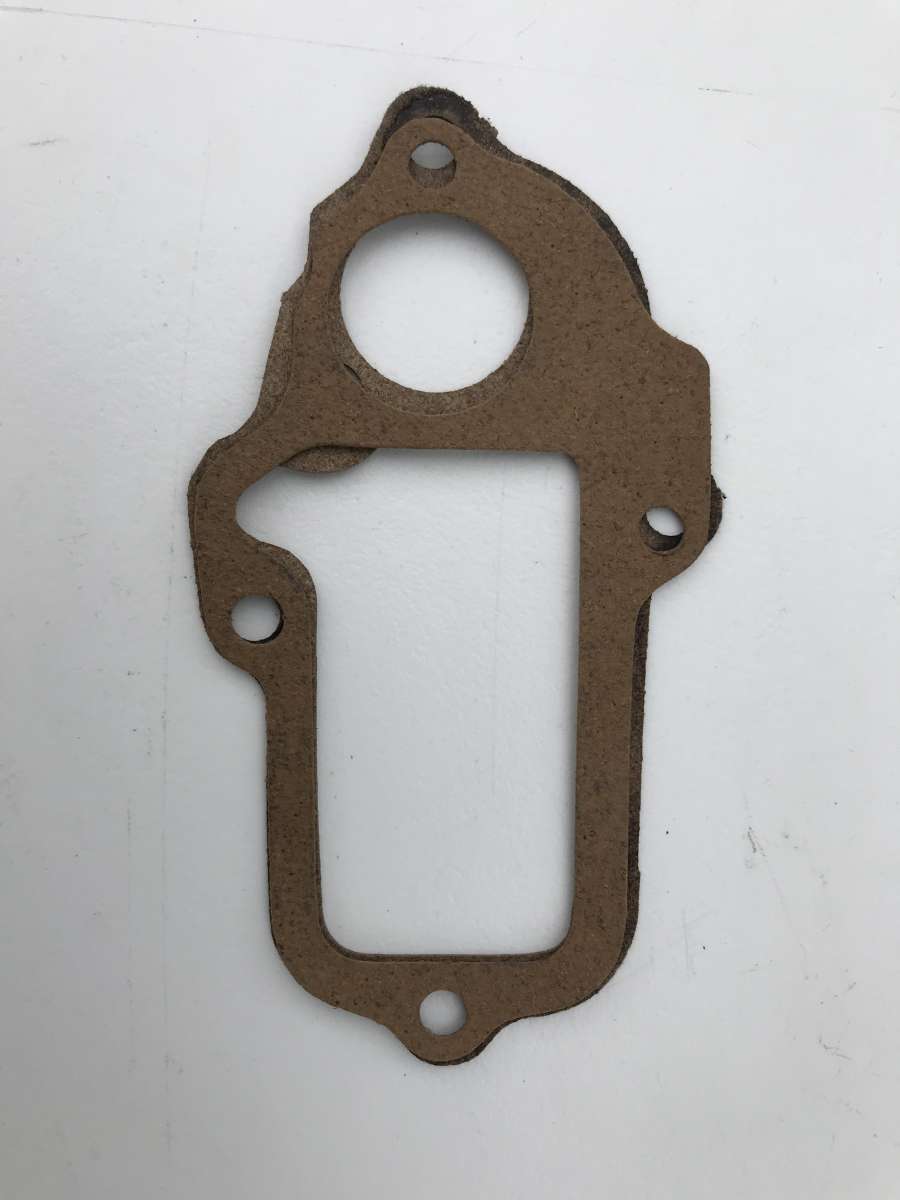

I may not be using the correct terminology, but I removed the float cover to find the float empty as it should be but the needle valve seemed to be sticking when I tried to lift the float. After applying a bit of pressure, it seemed to move freely. I reinstalled the top using the same gasket in the carb as the one in my vintage rebuild kit appears to be too small. Maybe old gaskets shrink as the Carter W-1 I'm using is supposed to be a 346S just like the rebuild kit version.
Engine started right up and I took the car for a short spin with no sign of leaking when I returned.

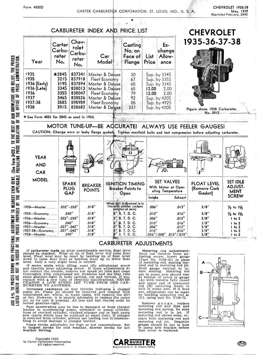

I've attached some documentation from the rebuild kit that may be of some use to you if you don't have it already.
IMG_0219.JPG IMG_0221.JPG IMG_0188.JPG IMG_0196.JPG IMG_0231.JPG form 4550D pg1of4.jpg form 4550D pg2of4.jpg form 4550D pg3of4.jpg form 4550D pg4of4.jpg

Carter used velumoid gasket material, which did shrink with time. This is an issue with trying to use new old stock kits. The good thing about the genuine Carter kits is that they do contain items not found in any other kits.
