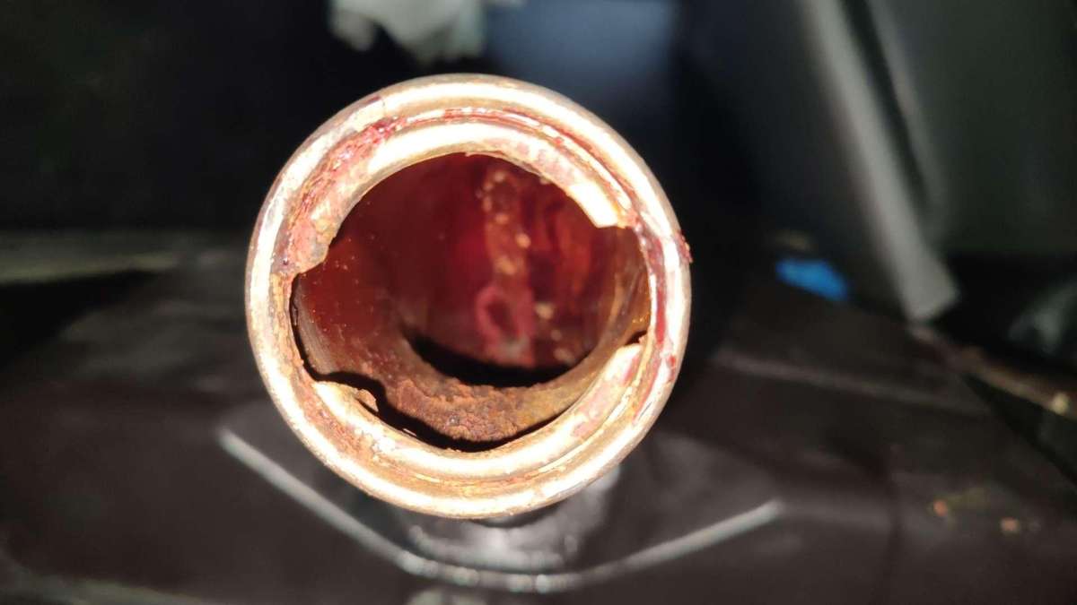

My impression is that you are already working with a replacement tank and filler neck. That whole area looks way too clean to be original. While I realize that the tank in a coupe is inside the car, there should still be some surface rust and more dirt/dust.
Based upon that assessment, I have to wonder if whoever did that work bonded the neck to the tank with some type of adhesive/epoxy or maybe JB Weld.
Have you tried using a heat gun to heat that area?

Bit of background:
It's tricky to say if the tank is new honestly, this car is extremely original as it sat in a private collection for around the last 20 years and had been entirely restored prior to that. Take a look at the underside of the car for peats sake lol! It's cleaner than the tank is.
That said, it might be an original tank because the inside of the tank does not look so nice. Someone coated the inside with a red material, which after sitting for 20 years basically turned into a loosely held-together dust. I know this because I was in the tank repeatedly, viewing it through the sending unit hole to see what on earth was going on inside it. The moment gas hit that old coating, it started to literally melt off the walls and it turned into a fine particle soup of red that looks like rust. Most of that gunk has drained out but, since it's heavier than the gasoline and the intake on the bottom of the tank is actually an inch or so raised from the bottom, there is now a perpetual pool of the stuff that gets stirred up whenever I get gas. The fuel filter was catching it all, but my lord it was making fuel filter swaps an every 25 miles deal. There are also some extremely odd/concerning solid-looking items in the tank. I hope to have this tank restored, hence I don't want to chop off my neck. But, given how hard the business coupe is to get a tank for, and how it seems this tank already had one or two or three liners done, I thought it best to get a new one while I still can. That's how I got here.
However, I did find a tag on the tank itself pointing to a "Seattle Radiator WK(works?)" company? I wasn't able to find any suggestions that this company ever made tanks, but I know this car came from out west so who knows.
To answer your question:
I have not tried a heat gun, mostly because I am sure there is still some vapor and/or liquid residue which has yet to evaporate due to the cold weather.
I spoke with RVA today and, as it turns out, they most likely supply the universal neck to The Filling Station. My filling neck is really just a longer version of the universal one. So, the current idea right now is to basically make a longer version of their universal neck, and try to do the first bend (first from the entrance). Worst case if the bend isn't right, I chop it off and use more tube. Either way, I am going to have to use some tubing. This really isn't the end of the world though as the inner/outer grommets on the end of the neck can hold it in place, and there is a metal rounded shute/guide on the inside of the car for the fill neck which the tubing can safely press up against.
UnderSide-low-resolution.png IMG_20230104_181205.jpg IMG_20230104_181213.jpg IMG_20230109_160642.jpg Tank Logo.png

If the interior of the tank is as bad as you describe I would not waster any more time and effort saving it. Unless the shop cuts the tank apart they will never be able to remove all the sealer that someone put into it. My guess is that there is some sealer still adhering to the walls but it will keep flaking off after you start driving the car.
I kept trying to “save” the original tank on my ‘37. Every 2 or 3 years I would have to remove it and have it cleaned. I also had a Fram G5 filter at the tank outlet that I had to change every 750 miles. The tank kept shedding a very fine rust.
If I had kept the car much longer I was going to replace the tank. I had way more money in it than the cost of the new tank.
