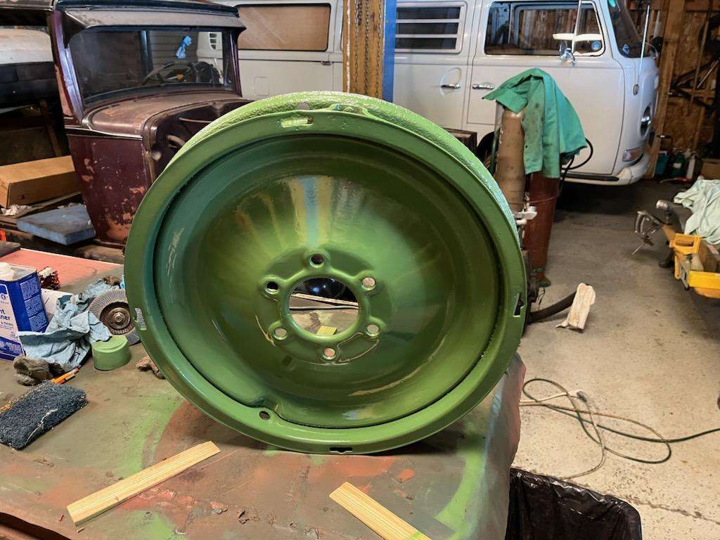

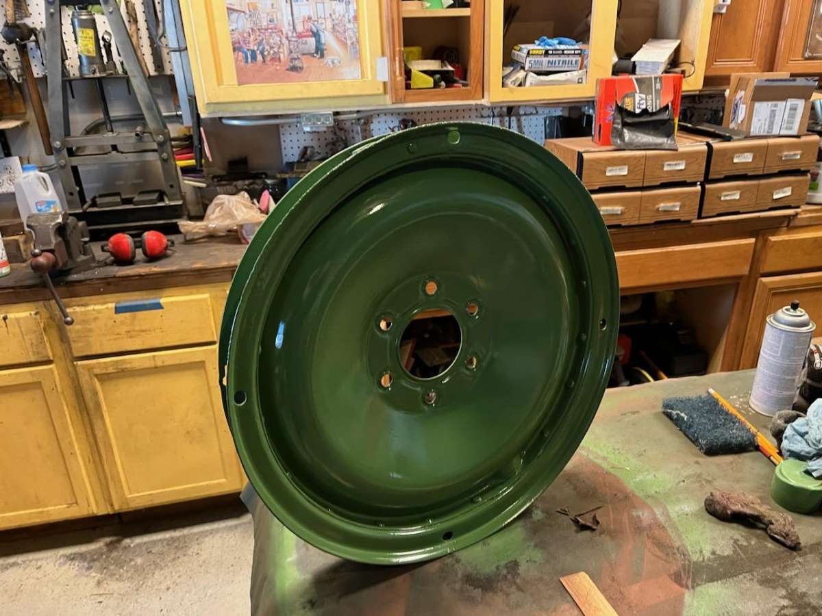

. . What size are the Green metal wheels you got from Gary Wallace? 1927 passenger wore 29 X 4.40 tires. 1928 wore 30 X 4.50 tires (AKA: 4.50 X 21” rim), 1929 wore 4.50 X 20” rim, 1930 wore 4.75 X 19” rim. All the trucks wore 20" tires and had 6 lugs holding the rim to the wheel. . .
. . If you want to use metal wheels with 32 X 6 (6.00 X 20) tires, find the wheels pictured on the 1929 LQ. If you want 4 wheel hydraulic brakes, use any Chevy half ton axle from 1936 – 54 on front. If you want a higher rear end ratio, use a ¾ ton axle from the 1980s in the rear that is semi floating and not full floating. They have ratios from 2.87 to 5.14. You will have to calculate engine HP and aerodynamics to get the ratio for best speed and mileage. You will have to use a torque arm or multilink rear suspension to use a T-5 with Hotchkiss propeller shaft to avoid spring wrap. . .
