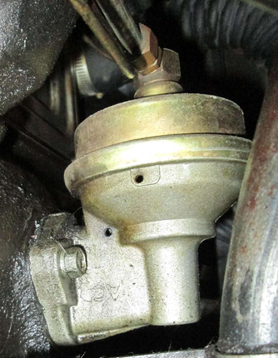

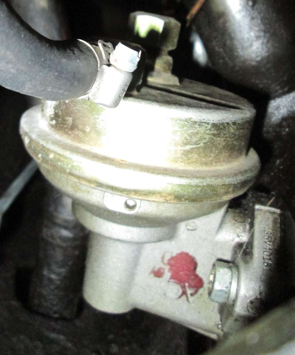

My 37 Master came with an AC 85V40151 Fuel Pump installed.
Is anyone familiar with this pump that could tell me more about it?
Since it wasn't originally installed on a 37 216 engine, what years were they produced?
Any idea if the input or output can be adjusted by turning with a wrench?
If I was looking for another, what model and year AC would I be asking for?
Thanks
Terry

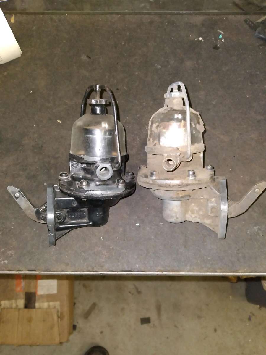

Your vehicle came with an AC fuel pump type number 429. It would have been the kind of pump that was screwed together and would have had a glass bowl on top. I will attach a picture. They are available and you can find them on Ebay and then rebuild it yourself with a kit or send it to someone in that business. Filling Station sells the kits. Then and Now Automotive would be my contact it you wanted an AC already to go. AC made a switched from the screw together type to the design you have. No adjustment. I could not find the number you have in a quick look but will check my shop books tomorrow.
The painted pump on the left is the AC 429
Dave

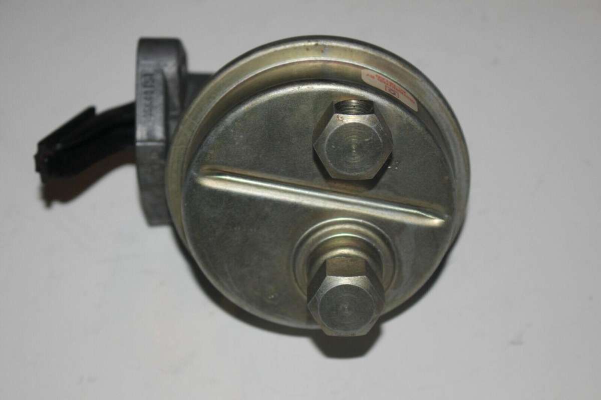

It would a bit of a letdown if the fuel pump on the 37 is from the 1970s. Even the 50's would be better.
I found that attached photos on eBay for sale of a 35K40151 that looks like my 85V40151 . . . . their description is "Dated: 1971 . . . My catalogs from '62, and '76 do not list this pump. It might have been a limited run and was merged with another similar pump number."
My 40151 has been working fine but I'm in the process of changing the carb from a Rochester B series to a Carter W-1 and I was hoping to avoid changing multiple things at the same time. I may have to reconsider changing to the AC429 to avoid bending the new fuel line to suit a 40151 when the 429 is more suitable for the age of the car.
Terry
Vcca#58150
