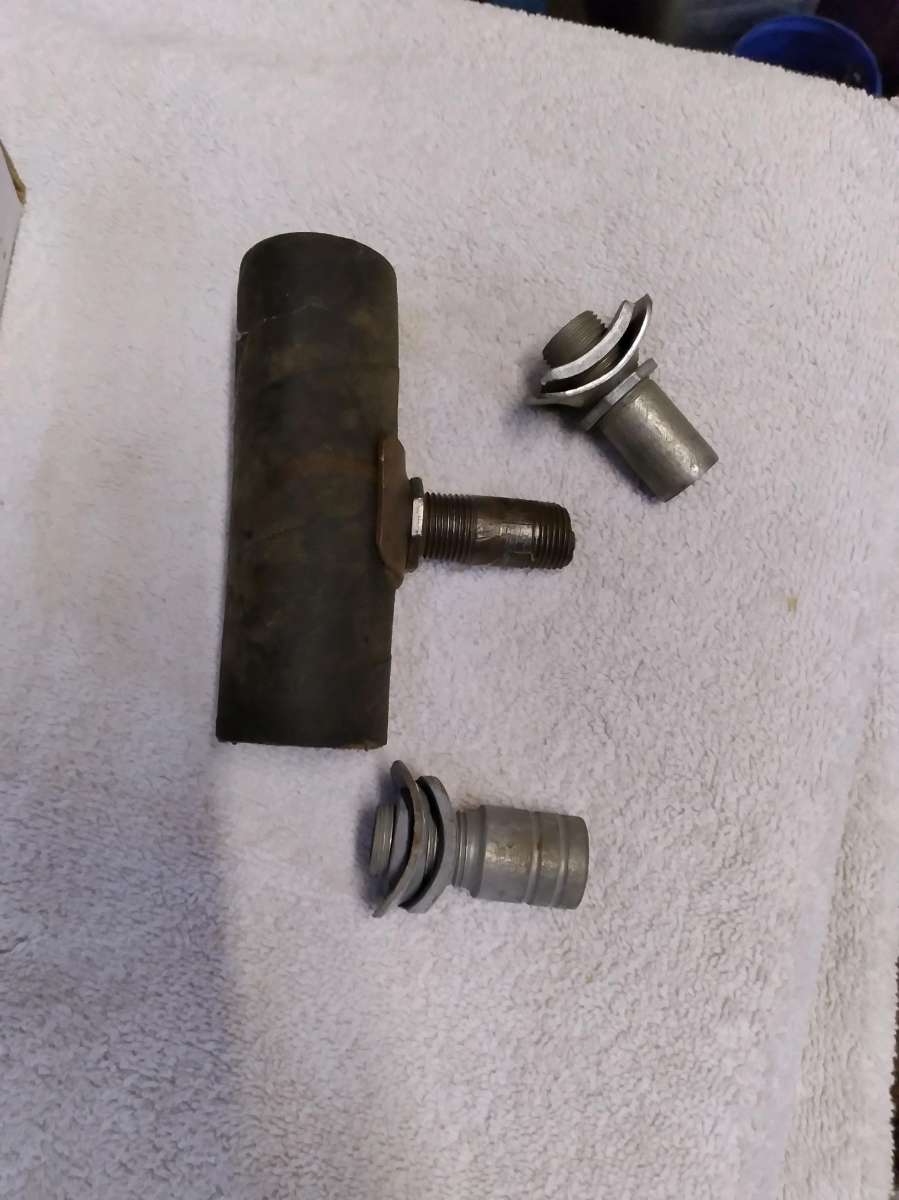

You could also use something like this.
Sunny,
I think I can send you one of the fittings for rubber hose as shown in Dave's post. I'm pretty sure I have a complete one that I will never use.
