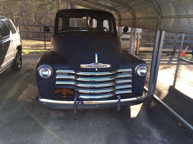

I have a 1948 Chevrolet truck with the 235 cu in engine. Just about 10 days ago my pressure gauge has started showing pressures of around 10 psi at highway speed and around 5 psi at idle. I've taken the truck to my "shade tree Bubba". He says they'll run a manual pressure check and determine if I have actual low pressure or a defective sending unit. He's also said that if I have that low of pressure, an engine overhaul is the solution. Couldn't it just be that my 70+ year old pump is getting weak and needs to be replaced? The truck is running great. I never drive it faster than 50mph. I run it on surface streets only- no interstate travel. The truck starts easily regardless of the number days between use. Opinions???
