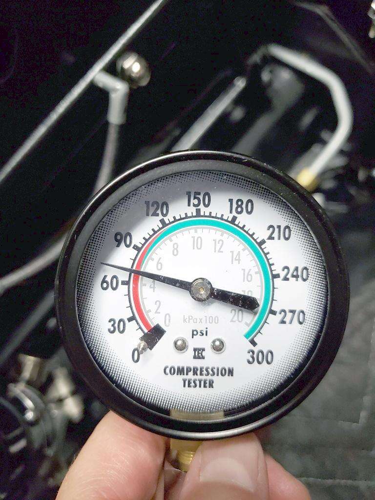

pulled all the plugs, and checked gap & coloration, they all were set to the .040" i set them to per VCCA recommendation, and they all looked really clean
did a compression test on all 6 cylinders, and got around 65-70 on all cylinders.
