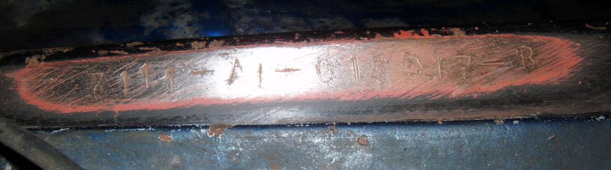

Today while investigating some wiring that was too close to the exhaust downpipe, I noticed a number stamped into the top of the chassis rail. I cleaned it up and found this 7111 - AL - 015017 - B
Tried to get a picture, was difficult but you can just about make it out in the attached.
Does it look right and what information does it give?

That is the serial number used on export cars.

That isnt the location or style used here in Aus. The number we use is stamped into the vertical face of the left rail between the rear of the front spring shackle and where the left hand drive steering box exits the chassis. The number on my 38 1/2 ton is "S38-**" but is also Holden body.
