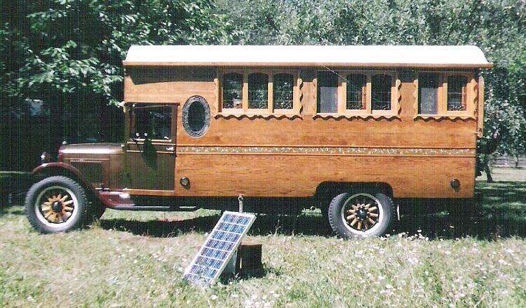

Photos are of an Oak- bodied.... Bus/RV/Camper that I Built from a 1928 Chevy one ton truck...... we traveled and lived in it for several year.. it had a 4.3L carbureted V6 Chevy engine, 5 speed, rack &pinion.... FUN.... it cruised safely at 70 mph on the interstate.....
bus 1 001 (3).jpg bus 2 001 (2).jpg bus 3 001 (2).jpg bus engine 001 (2).jpg bus wood 1 001 (2).jpg bus side ## 001 (2).jpg bus interior 2 001 (2).jpg bus interior 1 001 (2).jpg sepia bus front 001 (2).jpg
