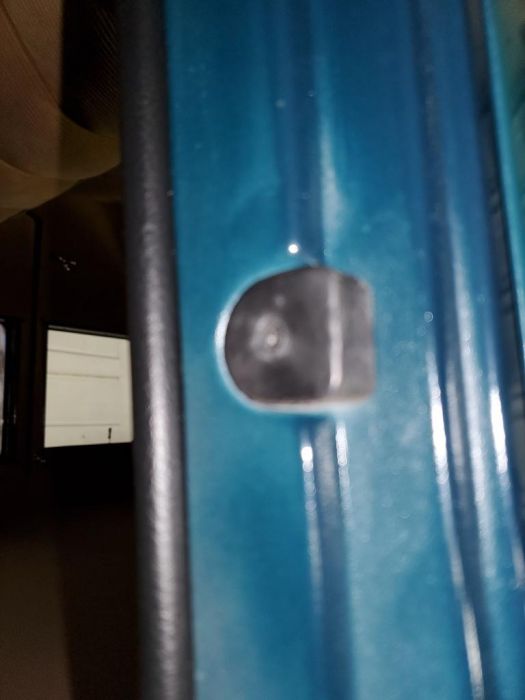

The two holes are for rubber bumpers. They are rectangular with the arched side to fit into the recess and held by a screw into the door frame.
Put a wanted ad for the door latch and likely someone will have one. Make sure you get the needed side and application as they are not universal.
here is a picture of the door bumpers on my 1929 4 door sedan. they are produced by Steele Rubber here in US, Part No 70-1155-71 someone may have them over there for you.

By some of the modifications already performed on the car it would appear to be headed for becoming a resto-rod. If that is the case it would probably be best to change those original door latches to a bear claw style. Much more secure for a car destined to go much faster than original. You will still need the rubber bumpers. They have a screw through a precast hole that hold them in place. Each door will have 2.
