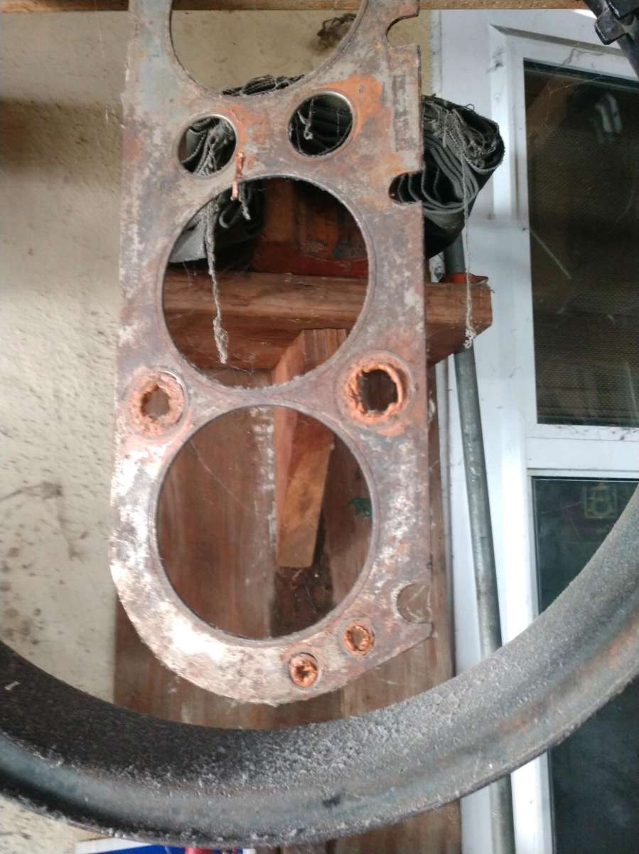

When I first got my '28 Canopy Express, I took the head off to do this type of inspection and I found lots of rust and crude in the head waterways.
I also found also that the previous owner put so much sealant on the head gasket that ALL the water holes that carry coolant from the block to the head were SEVERELY restricted. I kept that head gasket hanging in my carport and shake my head every time I pass it. See the pic.
Dean
