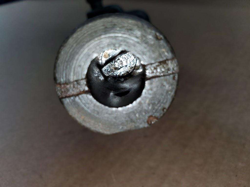

i made a custom rod tool for priming the engine, before that i used a dowel rod, yeah wooden !!
first time is a little scary, then after that is not so bad. learned how to set the timing, set distributor, find TDB, etc... all part of the fun of learning these old Chevrolets.
Few pictures of the tool i made, and end view of the Oil pump.
the round end of hte tool fits in my little 12v cordless drill, the slotted end mates up to the oil pump shaft. I put a little grease/oil on the toll so it goes in smoothly and does no harm.
found a few pictures of when i used hte tool and set it up to the pump
