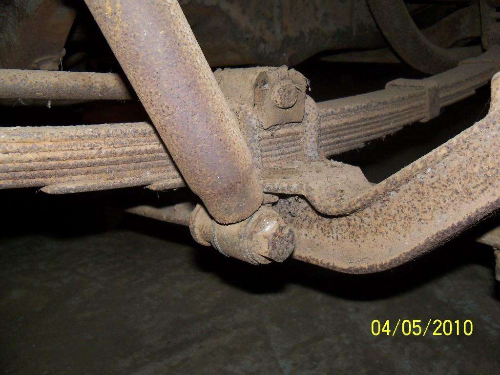

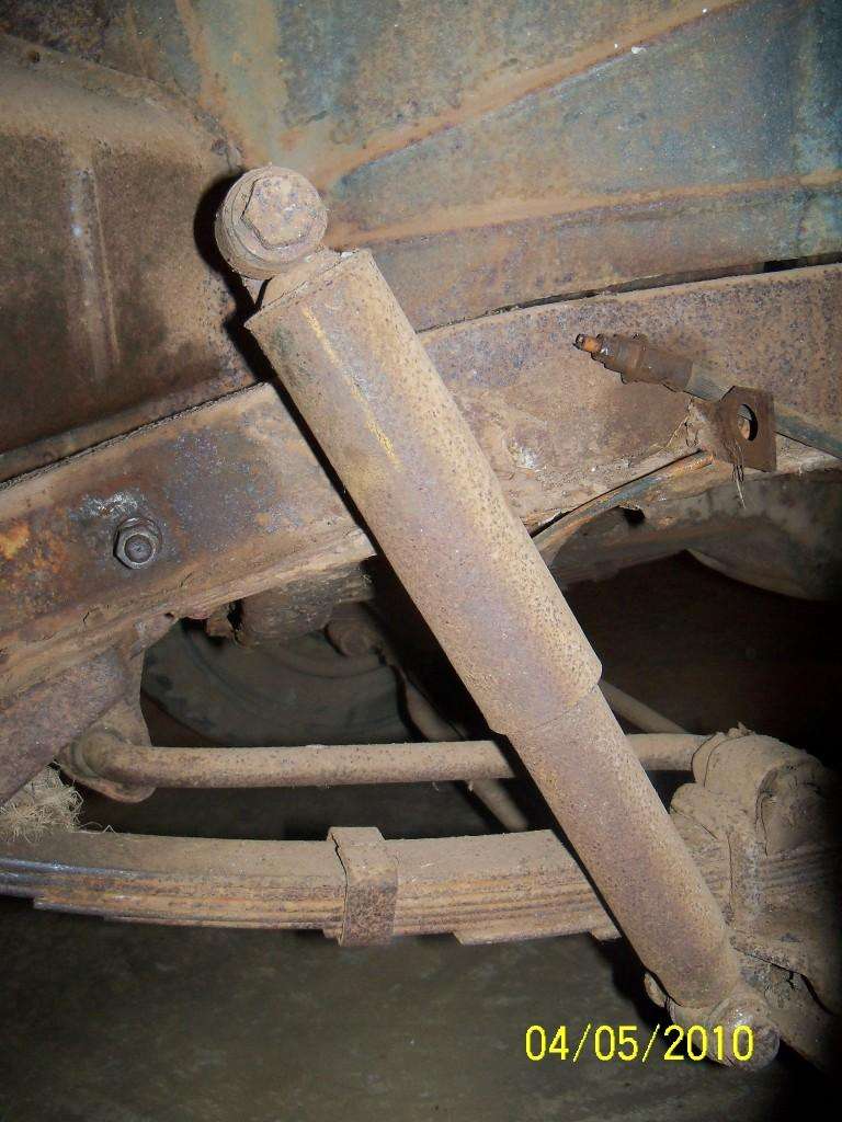

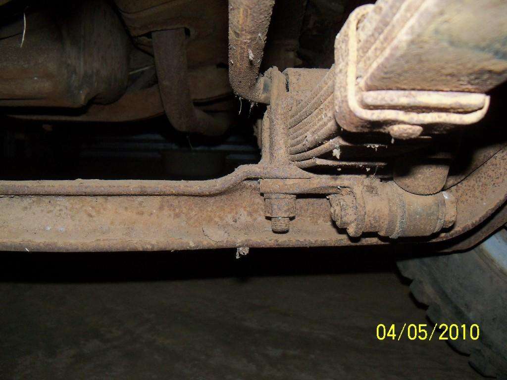

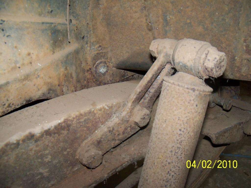

I converted my 38 to modern tube shocks. If you can find a set of 39 front shock mounts you can use them or there are some vendors that sell conversion kits or so I've been told. I used 39 mounts on mine. Below are pictures taken of the mounts I purchased before they were removed from the donor.

I don't know if these will work on your car but they might: https://vccachat.org/ubbthreads.php...-car-parts-chevy-vintage-old.html#UNREAD

WOW Tiny,What a sweet deal that is man ! They look perfect ! Boy do I wish I lived closer to Detroit,I would grab up all that stuff !! Thanks for the lead friend,Jay
