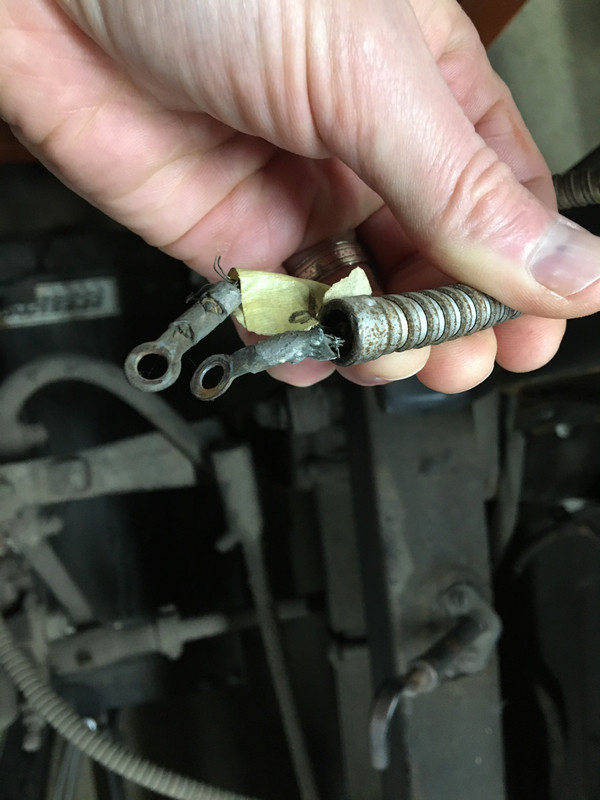

I’ll take a look at mine tomorrow and try and get a picture for you.

No boot on mine just conduit with 2 wires coming out.
[Linked Image from i.postimg.cc]
Thanks for the picture
I have never seen a boot or remains of one. I have NOS wiring harness(s) for late 30s trucks. They have the conduit but no boot. The Filling Station, Jim Carter, and Classy Chev USA, all sell the horn conduit. I make them and also conduits for tail lamp wires. The horn conduit is 14 inches long. Tail lamp conduits are 28 inches or 36 inches, depending on application. The Master Parts Catalog says most Chevys used these throughout the 30s.

You're right, I've never seen a Boot in the 30's.
