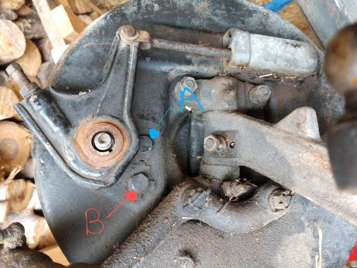

Pardon my ignorance:
Which bolt is the centralizer clamp bolt? The service manual indicates bolt "A" (top) but that does not make any sense to me. That bolt has a free spinning nut on the back and goes through the shoe mounting bracket which is rigid.
I assume it has to be bolt "B" on the bottom?
this is the diagram from the 1930 Service News brake section

Trreiinke, the centralizer is bolt B. The bolt is prevented from coming all the way out by a cotter pin through the end of the bolt on the inside of the backing plate.
Bill Masters
My Raybestos manual says to loosen both and then centralize so I don't think it matters which it is.
The centralizer is the adjustment so both brake shoes contact the drum equally. Once one understands that the need to centralize is realized and stopping performance maximized.

Thanks for all the information! I am having an issue with the small shoe rubbing. I am hoping that centralizing will help.

Trreinke, in my previous, I was thinking about a 1934. The centralizer bolts look the same from the outside.

Having recently purchased a 1931 Special Sedan I too was puzzled by the mechanical "Huck" brakes and the need to centralize them. The braking action on my car was terrible to the point that i didn't want to drive it until I figured out what was up. I finally just decided to pull a drum to see for myself. What I figured out is simply that the entire mechanism the brake cam passes through can be loosened and free to float and find its own center so both shoes hit the drum together. Thereby "centralized". I needed to see it to get it!
While I had it apart I thought some photos would be helpful for others.
As it turns out I had some some stuck adjusters, A bird-caged left front cable. Nothing centralized and one seized pivot.
On the bright side the shoes were brand new!

Once you freed up the brake mechanics, did the new brake shoes work properly ?

Yes. It made a huge difference.
