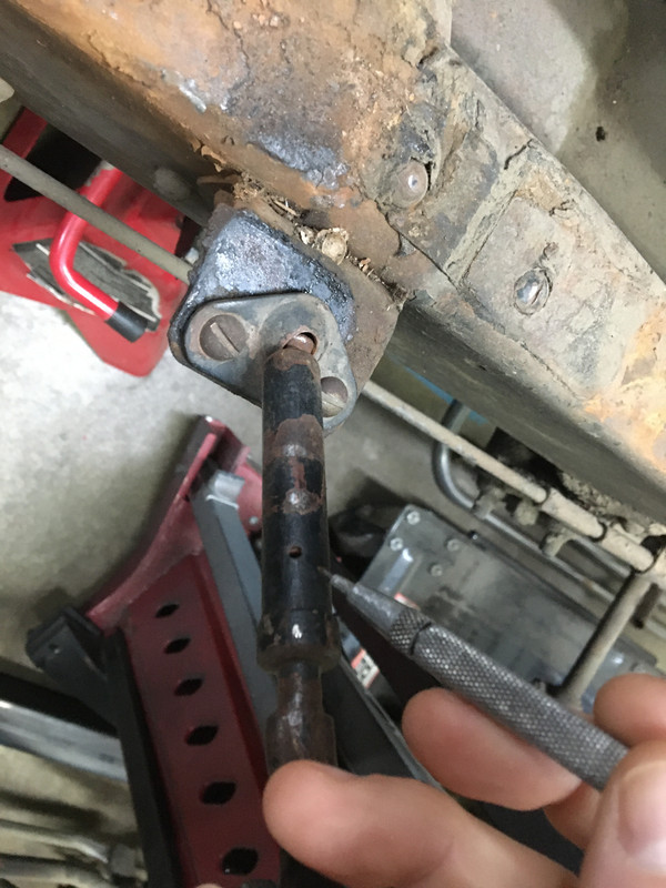

There should be a hole in the tube section where you can put a few drops of oil or penetrating fluid. Working them after application should result in increasing movement.

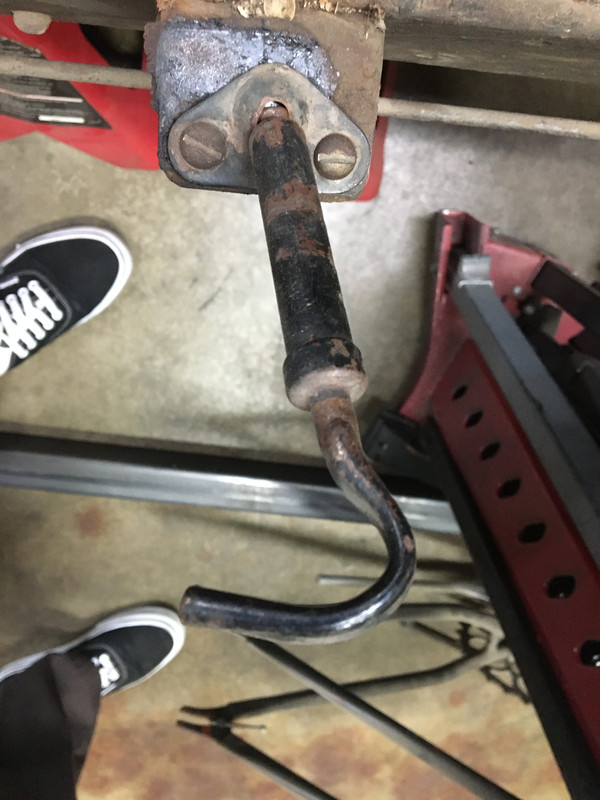

Hopefully these will help you. From my 31:
[Linked Image from i.postimg.cc]
The scribe is pointing to the oil hole referenced.
