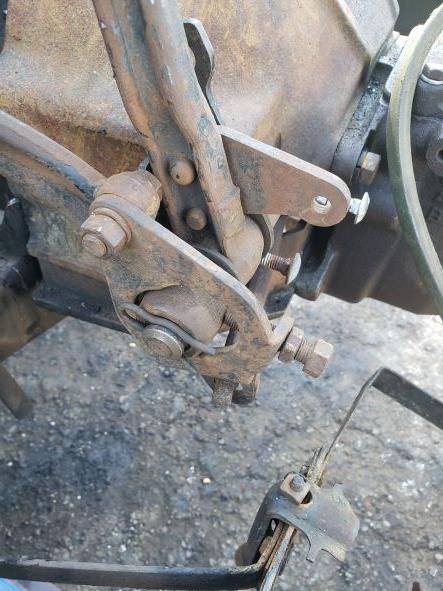

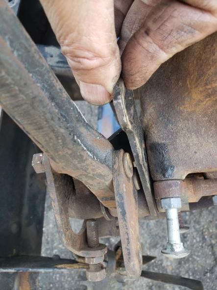

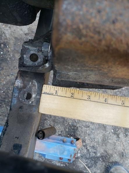

My 31 motor and trans came with no pedals so I found a set on ebay. Does this look right? WHats with the slot in the bracket closest to trans. I assume it should have a return spring to keep it from riding throwout bearing,in the video looking inside bellhousing I am pulling pedal back so bearing lifts off the assembly. . And also I am installing this drivetrain in a '25 chassis,is there any reason I should not cut the tip of the propeller shaft? I am so close to perfectly being where I need to be that I would only need to cut a half inch off or so. I already have about a half inch before the propeller shaft bottoms out in the trans.

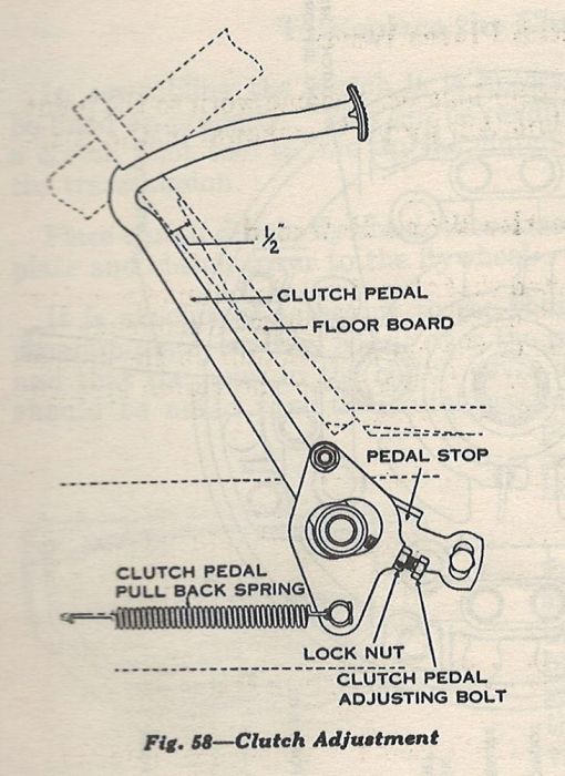

The slot on your picture is the pedal stop, but it is in wrong position. It is bolted to the rod "B" to stop the centre cross shaft flexing under braking pressure. If it is set correctly, the throwout bearing does not lift off the assembly so much like on Your video.

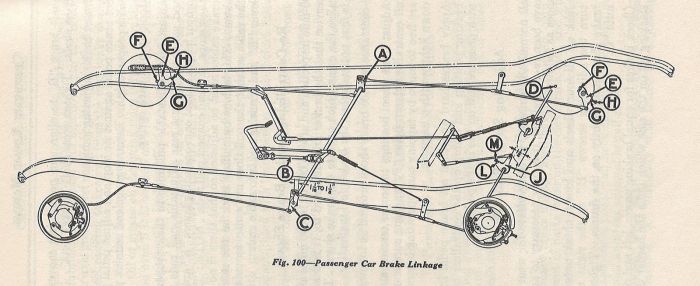

Thanks Mihaly, That picture and info will help a lot. I am trying to help a young man with his 30 sedan. It should have that same type of brake actuation assembly. I was not sure of how that all goes together. Whoever put the car together cobbled up a 29 rear end into a 30 car. The brake rods are laid against one another and rather poorly welded together. The two cross bars activating the brakes are the 29 style pulling the front brake cables. The consensus is that it is best to get him a 30 rear end. I have located one up here in the Portland area and I will be taking it down to him in the Phoenix area in 2 weeks. I have the single cross shaft I saved out of a 30 coupe a body shop was hot rodding. That should get him close to operational.

Here is a very good chart of the procedure of brake adjustment. The pictures scanned from the same page. The text of the General Inspection is complete on the second part only. The chart does not show the rod "B", although it is a very important part. It is because to adjust rod "B" is the first step of the clutch adjustment. It adjusts the cluch pedal stop and the brake pedal stop at the same time.
