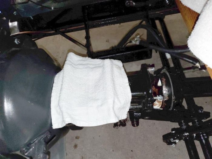

you will have to angle the engine up, and get the front bolt/stud up out of the frame and then slide it gently forward, you may have to wiggle it or rock it some to assist with getting the shaft out of the u-joint. the the torque tube will slide out of the u-joint. torque tube along with mushroom (u-joint housing) and shaft will stay in the car with the rear end, engine transmission, and u--joint will come out. there is only about an inch or so between the head and the fire wall as well, you will see that i used a piece of carboard to help protect my firewall. it is and angles up and out process. clear the oil pan and away you go.

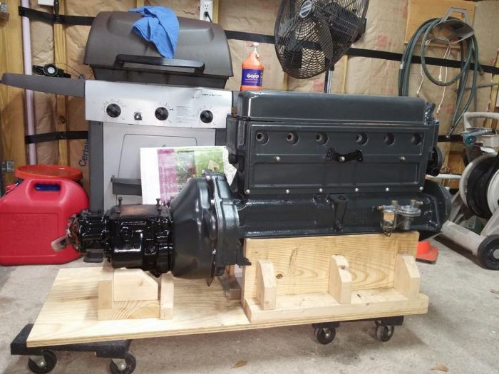

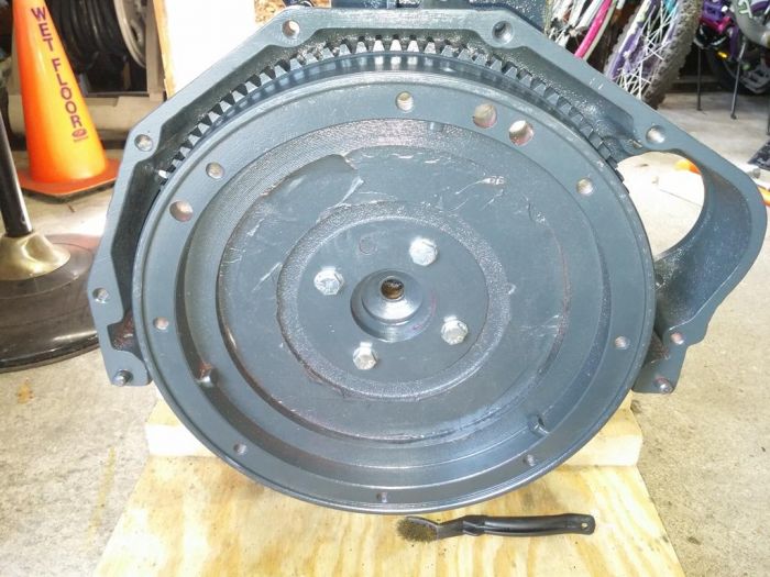

will take more effort to leave the gearbox in the car vs pulling it out as an assembly based on how they are connected together. not like a modern car.
it is a lot easier to line up the clutch disc, pressure plate and all with the out of the car, sure it can be done but not fun. also will need to support the gearbox some how as the gearbox is screwed to the housing which is screwed to the engine which is screwed to the frame. you remove engine and the cast housing, there is nothing to support the gearbox.
few pictures of my reassembly on my 1929 a few years ago. the cast housing is bolted to the engine from the inside of the gearbox housing. and this cast housing has the feet that bolt the driveline to the frame.

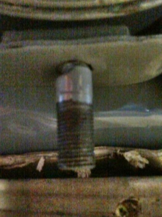

The front bolt is welded to the front engine support. You have to lift the front of the engine high enough for it to clear the front cross member.
agree with Chipper , the front bolt/stud does not come out.
as noted in my earlier posting:
Do you have the 1930 Chevrolet Repair Manual ?? if not I would highly recommend it, it goes through how to remove, replace, and do general overhaul of the drivetrain. clearances, setting, etc. many which are critical to the survival and running of these engines :)
pict of inside the front cover where the bolt/stud is located. this is on my 1930
