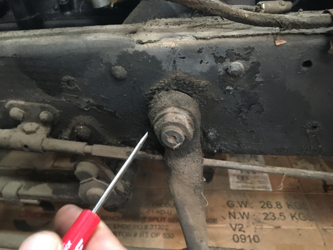

Now, on mine I have i big nut that runs through the frame to the pitman arm the gearbox itself is riveted to the frame at 4 points.
Do any of these pictures have what you are referring to?
[Linked Image from i.postimg.cc]
Or is it shown in the manual? If so do you know the corresponding letters?

The screwdriver is pointing to one of the two bolts. It is kind of like a connecting rod cap and clamps down on the part of the housing where the sector shaft runs. The rivets are probably holding the base of the bracket to the frame. I will be back in the shop tomorrow and send some photos.

I’m assuming the picture on the bottom(not pointing at pitman)? If so that a great help but I’d still love to see the other pictures when you can. Thanks so much.

@Dave39MD Don’t worry about pictures tomorrow. The one you posted was enough. Got it! Thank you so much! Btw any pictures of you cabriolet? I’d love to see it if you have a thread.
