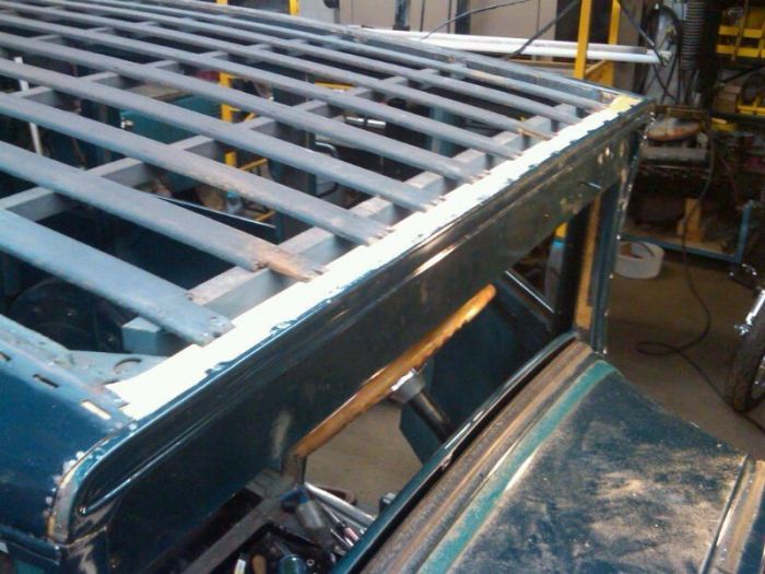

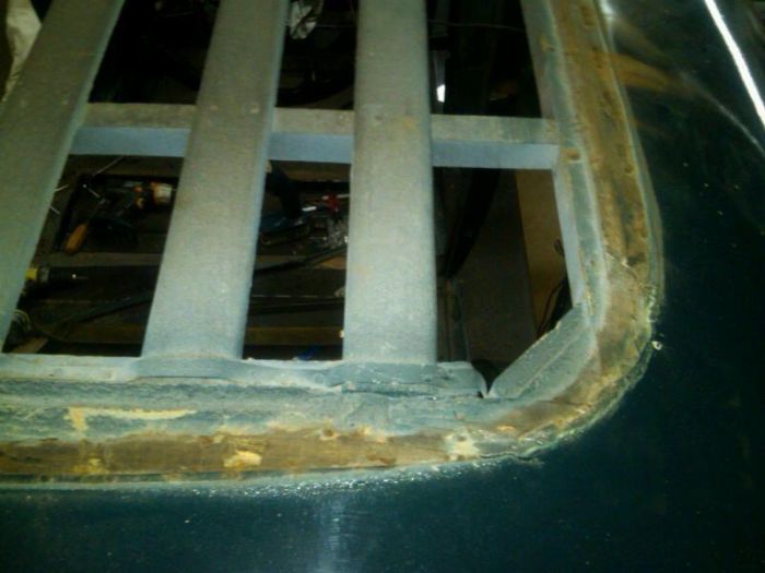

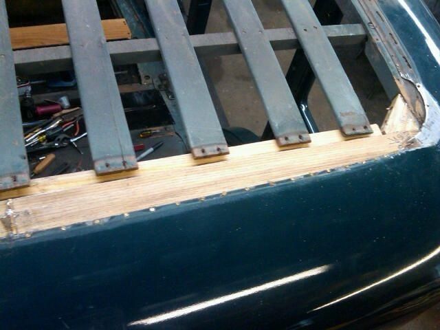

My biggest problem is, I do not have any bows. I don't even know what they are supposed to look like. I could sure use some pictures. Any help would be appreciated.
Then an original style headliner cannot be installed. Why do you not have roof bows?

I did not even have a roof to start with
Like this.
Joined: Mar 2021
Posts: 4
Joined: Mar 2021
Posts: 4
Might have mentioned that a bit earlier.
Joined: Aug 2019
Posts: 300
Joined: Aug 2019
Posts: 300
The bows aren't metal bows? They are the wooden bows for the roof? Is that correct?
that is correct WOOD
few shots of my 29 four door
