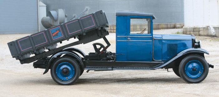

The green truck is listed as a 27' and the blue is listed as a 29'. The 29' looks like the cab I'll be working on. How much wood do you need? Are your doors gone also or just the cab wood. The cost is not cheap and who ever makes the wood other the KC will need the sheet metal to recreate the wood. Jim Rodman probably has patterns also. I rewooded a 34' high cab recently. If you'd like to see some pictures of the wood work, PM me your email.
